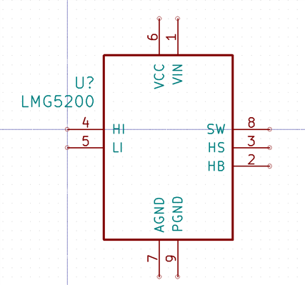

LMG5200 GaN IC
symbol LMG5200.lib
footprint lmg5200.pretty.zip

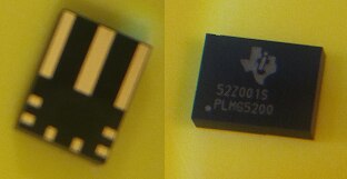

There's no existing symbol or footprint for the LMG5200 GaN half-bridge.
I used Dave Vandenbout's KiPart script to generate that part (read: copy-paste datasheet info into a spreadsheet and generate symbol from that).
LMG5200
typepinnameside
pwr1VINtop
output2HBright
output3HSright
input4HIleft
input5LIleft
pwr6VCCtop
pwr7AGNDbottom
output8SWright
pwr9PGNDbottom
See this blog for more info and instructions: Create my first KiCad part with KiPart utility.
The result is the following symbol:

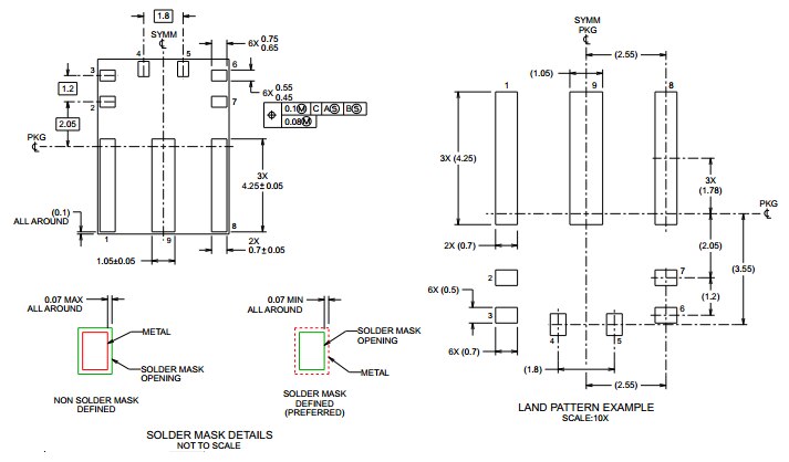

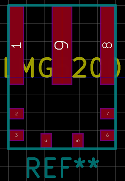

To create the footprint of this item, I used the Package Information section of the datasheet.
I used the footprint editor to redraw package, copper and solder mask. There's a little bit of calculations needed to convert all the info in the images to coordinates.

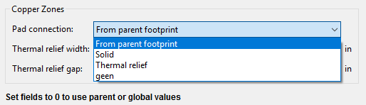

Because the copper pads should blend with the PCB flood filled areas, I've set the pad's footprint to "From parent footprint".
This to avoid that we get thermal reliefs. They are not appropriate for this component (in particular for pins 1, 8 and 9).

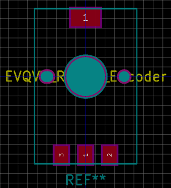

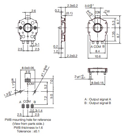

EVQ-VVD00203B Square SMD Encoder
symbol: rotary_encoders_jan.lib
footprint: Panasonic_Rotary_Encoders.pretty
This one also doesn't have footprint or schema symbol. I used the KiCad editor to create the schema. I didn't go fancy.

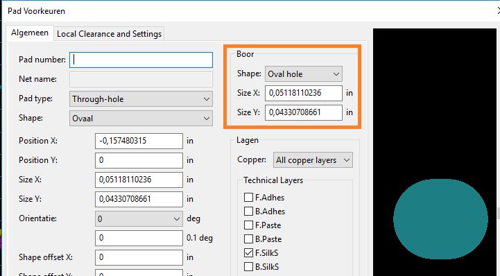

The footprint was tough. The device requires three mounting holes, one of them oval.
You set the shape of the drill in the pad preferences.

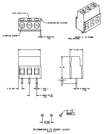

282841-2282841-2Terminal Block 2x1 5.08mm TH
footprint: BuchananTerminalBlocks.pretty
For this one, I only needed the footprint.
This one is straightforward. Nothing special.

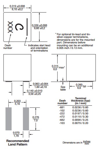

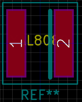

XAL8080-472ME Inductor, Shielded, Composite, 4.7uH, 10.5A, 8.89 ohm, SMD
footprint: coilcraft_incuctors.pretty
image image
Again, only the footprint was needed. Just a transform from datasheet measurements to the KiCad footprint editor coordinates.

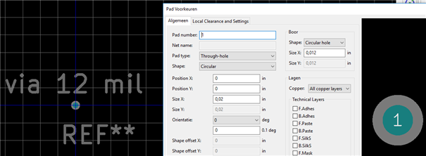

VIAs
footprint: vias.pretty
There's not much to be said about these. I made them to stay as close as possible to TI's reference design.
I needed 12 and 38 mil vias for that. Even though KiCad has via footprints, these two values aren't available.

    I love it when a plan comes together: It was a bit of a hammer to create the encoder's footprint but it turns out it's a perfect fit. The shaft can be fitted on the front or backside.
    Jan Cumps over 9 years ago in reply to Jan Cumps
