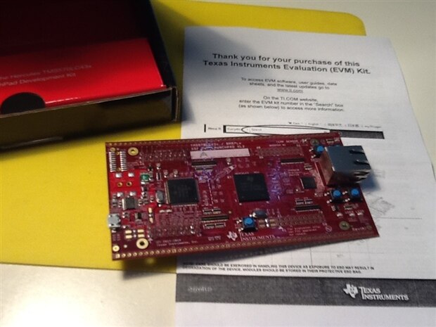

I have the new Texas Instruments Hercules LaunchPad here at home.
It's the  LAUNCHXL2-570LC43LAUNCHXL2-570LC43 with a TMS570LC4357 microcontroller
It's the first Hercules LaunchPad with Ethernet connector. In this post we'll use that connector, and the Leightweight IP library (lwIP).

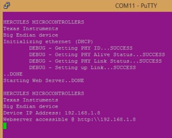

If you meticulously follow all the steps and load the code to your controller, you end up with a  running mini web server.

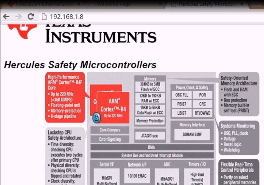

Connect the LaunchPad to your network (it got an IP address straight away from my DHCP enabled router at home), and log into the serial port with a Serial Terminal (see this post for details).
Surf to the URL that's logged in the terminal, and you'll get treated with this screen.
