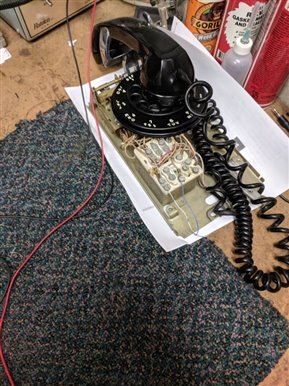

The next thing I had here on my parade of projects was going to be a classic! My dad had this old rotary ringer telephone in the shop here. It reminded him of the good old days of how telephones were and was using it here for a little while until we switched over to a VoIP telephone system in the office and shop and basically the voltage form the phone lines would surely not make the ringer nor the phone work at all!
So naturally I got my hands on this phone when we took off the wall and I suggested to him, why not turn this into a VoIP phone to work with our current service? The idea was amusing but it was pointed out to me that the ringer bells need at least 80 volts and some high current in order work, and the originality that would be that phone would be strange without. There was a point there, I didn't want to just use a synthesized sound or an MP3 to emulate the ringer at all, there had to be an application where someone must have gotten ringer bells to work with a low voltage and bumped it up to make some high voltage square waves to ring some bells, luckily such an application existed!

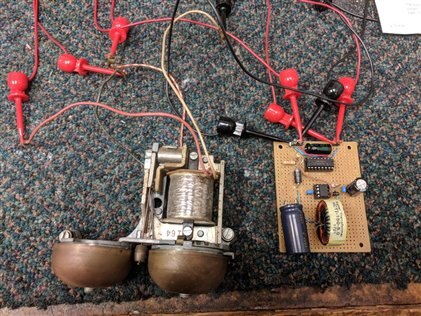

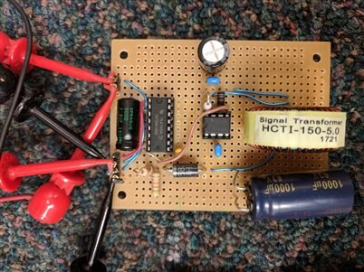

imageTo paraphrase a little, two big DC voltages are going to be created from 3.7 volts, each typically from a LiPo battery or I hope in my case, the supply off the GPIO header pins that have the 3.7 volts there. Once the two big DC voltages are made, they are going to be run through an H-bridge configuration, in this case the SN754410; one Vcc as the supply and the other one, Vcc2 is used for the signals on 1A and 2A which will make a 0 to +V square wave at approximately 22Hz and 180 degrees out of phase with each other. The larger DC voltages are achieved by using a boost converter, in this case a MC34063A which will be doing this for us.
I had previously purchased the parts and had this project on standby for awhile now. Seeing I had a working schematic and knew what to aim for here, I did go ahead and construct the working prototype to see if I could get mine to ring here.
The circuit has been built, as above, but not preliminary testing has been done yet. I will likely make more updates here when I have made sure that all connections are correct.
