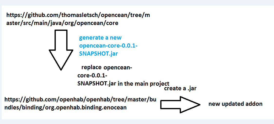

This snapshot comes from the opencean-master file.
The second part is the addon itself which is located into the org.openhab.binding.enocean file.
Here is how you will have to build your enocean addon:
In order to create a new addon you need to create the snapshot first:
opencean-core-0.0.1-SNAPSHOT

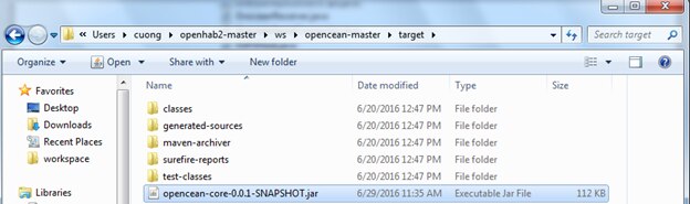

open a cmd.
You NEED to have a maven on your computer.
Go in the folder where is located your opencean-master.
Use the command “mvn install”
It there is no error it should create the snapshot:
This snapshot is located in the “target” folder of opencean-master.image

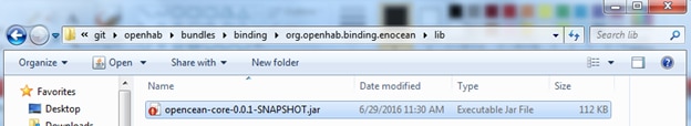

Now we have this snapshot. We have to REPLACE the old snapshot in the org.openhab.binding.enocean folder by the new one.
The new enocean binding is now “updated” .

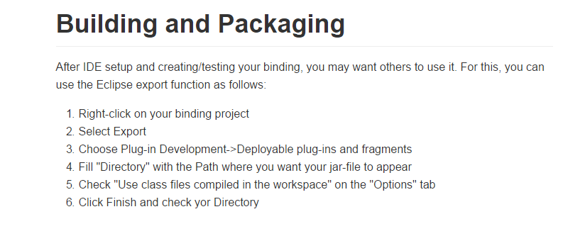

It's time to build the addon.
There are very detailed information on the github website.
https://github.com/openhab/openhab/wiki/How-To-Implement-A-Binding
=> You just need to remember that now you have to open with eclipse the org.openhab.binding.enocean
and follow the steps
Once you get the .jar your have to replace this .jar in the openhab folder.
Now compile your openhab with debug mode and test it with your sensors.

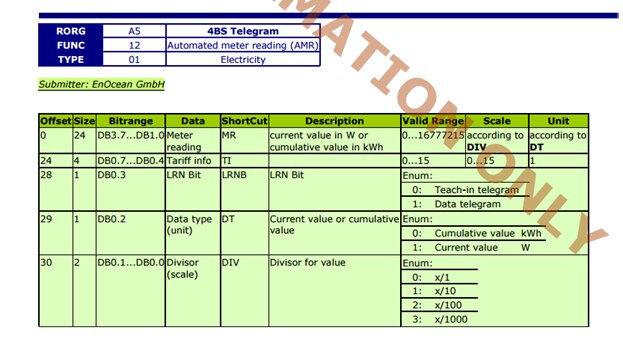

Step 3: Adapt your own addon, for example here A5-12-01.
1- You need to get the latest enocean datasheet: write “enocean equipment profile” on google and download it.
2- Find the datasheet of your sensor.
For example we decided to look at A5-12-01
Your have to understand what does it mean by looking the explanation at the beginning of the datasheet.

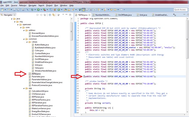

Now we have to change the source code in order to add a new device.
I suggest you to open 2 eclipses in the same time (one for your opencean-master and one for the enocean-master file).

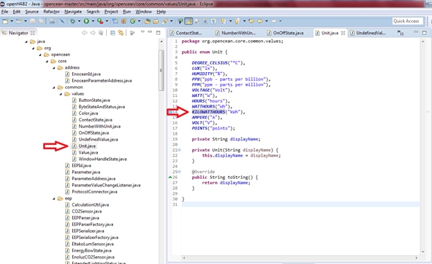

Add an unit if you need it: for me it was killowatthours
Add your device in the EepId.java file
Add your file in the eep.
Now you have to find out what you need in order to analyse the data that you will get.
For example, In the datasheet we see that for the A5-12-01, it is a 4BS Telegram. So we will use the file in the projet that use 4Bsparser.
Look at the other files to get clues how it is done and create your own solution.
For the A5-12-01. I did this in order to make it work.

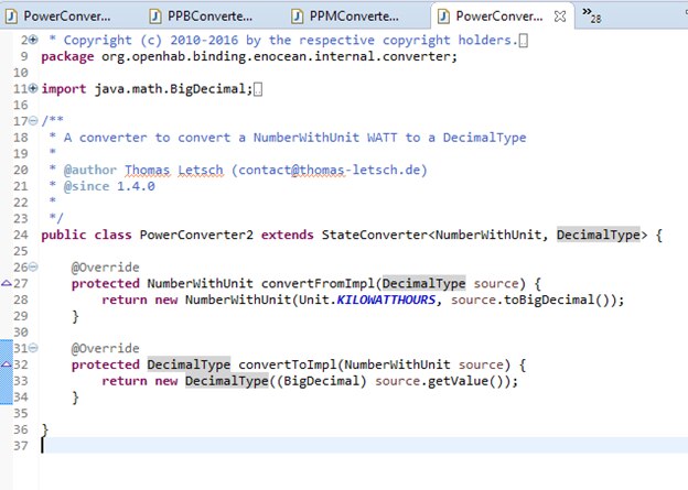

Now I have to create a snapshot of this opencean file. Make sure you saved every file before. Open the cmd and type the “mvn install” command in the right directory.
Replace the old snapshot by your new snapshot.
Let’s have a look at the enocean project now.
Take example of the other converters if you need it. My new converter for KILLOWATTHOURS looks like this.
And finally you add an import for the the StandardProfile.java file
If you look my source code I just added a line with the new converter.

When you export your project and create the new .jar file. You will notice that the new addon now work for your device A5-12-01
Number power2 " power1  [%.1f W]" <energy> (All)                              {enocean="{id=01:8D:C3:FC, eep=A5:12:01, parameter=POWER}"}
Number power22 " power1  [%.2f KWh]" <energy> (All) {enocean="{id=01:8D:C3:FC, eep=A5:12:01, parameter=ENERGY_METERING_VALUE}"}
The new addon you just created now support the enocean device.
