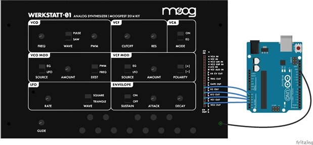

The Wiring for this project will be fairly simple. We are sending some signals from the Werkstatt, into the Arduino where they will be processed and passed along to Processing, and finally, from Processing to our computer screen. I always prefer to set up the hardware first, possibly because I find it easier, but as long as everything is in place at the end, your order of operations should not matter too greatly. From the Arduino, connect EG Out to A0, LFO Out to A1, VCF Out to A2, and VCO Out to A3, and connect a grounding post on the Werkstatt to GND. It could be interesting to use a breadboard to integrate other circuits into this setup. I would simply route the Ground wire through the breadboard rails and build whatever kind of circuit I wanted to additionally play with. Take a look at Werkstatt Workshop for some great ideas.image

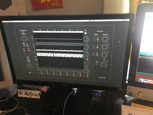

Now for some software. Presumably you've installed the applications downloaded earlier, so now connect the Arduino to your computer using an appropriate USB cable and launch the Arduino IDE. The StandardFirmata sketch is bundled by default in the File→Examples→Firmata menu. It requires no changes or additions, so simply upload it to your Arduino. Next we're going to load the Processing sketch I linked to. This sketch has been around for quite a while I think. It's definitely from before Processing 3, but I believe it works without modification. You will want to check to see if Processing has the Arduino(Firmata) library installed, it probably doesn't. Look under Sketch→Import Library…→Add Library. Use the filter to find the Library in question and install it if needed. Finally, Run the Processing sketch!
That's it, you're done! Power on your Werkstatt and watch the waves glide across the screen. I strongly suggest playing with the processing code to see what happens. Can you increase the resolution? Can you add a monitor for one of the other outputs? Change colours or sizes, maybe dig in to the sketches and see if you can use the information for something other than this pseudo-cilloscope!

Here's the thing up and running!
