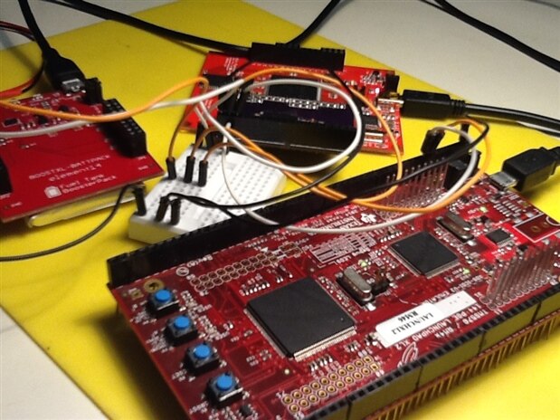

We know that it's tough to talk to the fuel gauge chip on the Fuel Tank BoosterPack. Its I2C interface is sensitive to right timings.
I tested the communication with a Dangerous Prototypes Bus Pirate, and captured some question-reply sequences with a logic analyzer.
It's now time to get it working in the final setup: with a Texas Instruments Hercules Safety microcontroller
The end-game of my project is to power a Hercules safety project with a LiPo battery. The Fuel Tank BoosterPack that I'm using has a 3.7V 1200 mAh battery.
(The BoosterPack is well known here at element14. It's designed by TI and e14, and has been the subject of a TI Fuel Tank BoosterPack & MSP430F5529 Launchpad and many blogs).
Monitoring the battery state is one of the parameters for a safe design. I'll check the state of the accu regularly.
I do that by firing I2C queries to the battery gauge IC that's constantly monitoring the battery health and state.
I've documented the protocol and queries in previous posts (see Related Posts at the end of this post). This is my first attempt to set up a communication between the Hercules microcontroller and the fuel gauge.

First FirmWare Version
I got it working - kind of. I've used the I2C before. But this is the first time that I do an I2C scenario with Repeated Start.
With repeated start, you have to send a new START command to your I2C slave without doing a STOP.
And although the Hercules I2C module is capable of doing that (it's documented in the TRM), I can't get it to work yet.
This video is unavailable.
It doesn't influence the scenario. The communication works also when I do send that bogus extra STOP. But it isn't as per spec. So I'll have to fix this or I won't be able to ever sleep well again image.
I've raised a question on the ti e2e forum.
Here are my preliminary results:
Entry 5 is the unwanted STOP.
Below is a subset of my code. I'll add an additional blog with the full project once I have the Repeated Start working.
