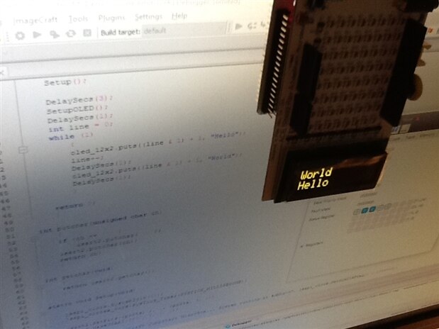

In part 1, I'm checking the out-of-box experience. Is it easy to get the boards and tool chain running?
Spoiler Alert: it's easy
Getting Started Fast
We all know what it's like to unpack a new development board, and then struggle for hours, days, weeks (hello, sama5d4, I'm looking at you).
That's not the case with this board. The Quick Start Guide walks you through software and hardware setup. Step by step, as it should be.
When completed, you have the drivers installed, the IDE up and running and the tool chain configured.
Compiling and running the first example works straight away. The OLED display was showing 'Hello World' without any issue. Perfect experience.
I tested 6 of the examples, and they all work flawlessly. The build cycle is fast.
The only thing I struggled with a little (and the quickstart guide warns you for that) is mounting the shield on the ST Nucleo board. The shield uses stacking headers, with springy sharp pins.
It's a bit tough to properly align the shield with the dev board.
With proper care, this works, though.
