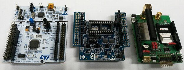

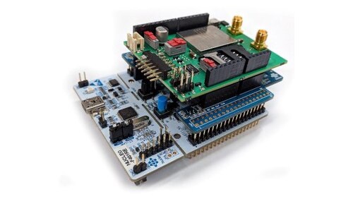

Hardware Platform
The hardware platform used for this project was an Avnet BG96 Arduino Starter Kit.  It consists of:
  •   STM32 Nucleo-64 development board  STM32 Nucleo-64 development board
  • Motion MEMS and environmental sensor boardMotion MEMS and environmental sensor board[1]
  • Avnet RSR1157 NBIoT BG96 Expansion BoardAvnet RSR1157 NBIoT BG96 Expansion Board
In addition to the hardware, a cellular SIM capable of data is needed. To verify the correct hardware operation and SIM card operation, you may want to download and exercise the demonstration programs from:
  • https://github.com/Avnet/BG96_Bluemix_QS
  • https://github.com/Avnet/BG96_Example.

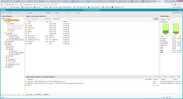

Using on-line Mbed compiler

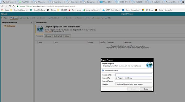

Go to the ARM Mbed OS developer site and login to start the compiler (https://os.mbed.com/).  You must register to get to this location (it is free).

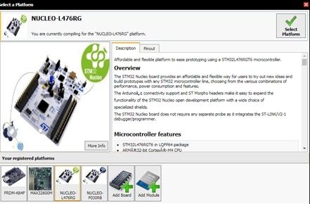

Once you log in, go to the “Compiler” page (yellow button at the top of the screen) and to add the Nucleo L476RG to your platforms (upper right corner of the workspace screen).
After the platform has been selected, you can import the AWS Sample code from the github URL https://github.com/Avnet/aws-iot-device-sdk-Mbed-c. NOTE: select the ‘Update all libraries’ will ensure you get the latest libraries.
With the project now loaded, you must update the security certificates and AWS_IOT_MQTT_HOST URL to reflect your specific values.
The security certificates are contained in the awscerts.h file that is located the certs directory.  Using the existing awscerts.h file as a guide, incorporate the contents from *-certificate.pem.crt, *-private.pem.key, and rootCA.crt that you created while working through the AWS IoT Example.
The AWS_IOT_MQTT_HOST URL is defined in the aws_iot_config.h that is located in the ‘examples/shadow_sample’ and ‘examples/subscribe_publish_cpp_sample’ folders.  This endpoint will also be unique to you thing that is created during the AWS IoT Example.
While the security certificates and end-point URL updated, you are ready to compile the code.  The initial example code created will be from the shadow_sample example program.
When working with the on-line tools, this AWS Mbed code will always compile the code that is located in the shadow_sample folder.  So later, if you want to compile the subscribe_publish_cpp_sample, you must copy the source file subscribe_publish_cpp_sample.cpp file to the shadow_sample folder and rename shadow_sample.cpp to shadow_sample.kep (to prevent the compiler from compiling then attempting to link it into the executable image).
Once the executable image has been created, the screen will look like:
Copy the executable program from your Download folder to the Nucleo board connected to you PC.  At this point you can begin the program execution as described in AWS Mbed Sample Execution.
