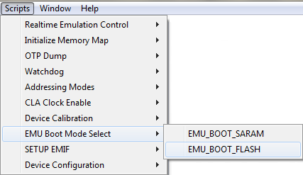

Writing code to Flash
The process of programming a microcontroller with CCS is odd to say the least. You first have to run the debugger, in RAM mode.
Once your tested your code by running it on the actual device, it's time to program it into Flash memory so the microcontroller will run on it's own.
Switch to flash mode:
Right Click on the project itself "Example_28379D_LaunchPad [active - CPU1_Ram]" and go into Build Configurations > Set Active choose CPU1_Flash
Now run the debugger again now it's in in flash mode.
The program is now written to the flash.
Press Resume to run the code to verify it works, then press suspend.imageimage
Then use a script in Scripts > EMU Boot Mode Select > EMU_BOOT_FLASH
to 'upgrade' it to boot to flash instead of memory. Now press Reset on the debug toolbar, then Resume. It should run the program again.imageimage
Now press Terminate to disconnect from the device.image
All going well you should be able to unplug the device, plug it back in (for USB power) and have it run the program standalone.
