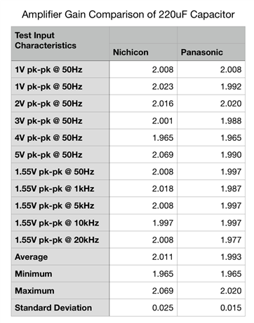

Amplifier gain
The gain was calculated as a ratio of the input and output voltages. Nominally, it is expected to be 2.0 based upon the resistor network installed. The gain is displayed in the table below, along with basic statistical values.
The polymer capacitor seems to slightly out perform the electrolytic capacitor. The spread of results is slightly tighter and the average is closer to the nominal value for the polymer capacitor.

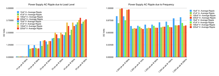

The AC ripple seen during load changes, follows a reasonably uniform data plot with an expected increase in AC ripple as the load is increased. Significant differences are seen at the lowest load, with the 47uF and 220uF capacitors both displaying a much lower ripple value. At the 4V input, about 2.50A output, the 47uF capacitor shows a break from the trend, with a much higher AC ripple than any of the other capacitors.
With frequency change, the 47uF capacitor shows a constant AC ripple across the data plot. The other capacitors have a much higher AC ripple at low frequency that reduces as the frequency is increased. At the higher frequency the AC ripple creeps up for the 10uF and 47uF capacitors. The 100uF and 220uF capacitors have a slightly lower AC ripple at the highest frequency.

Moving on to the AC ripple measurements, the results for the load changes seem to be opposite to expectations. Although the AC ripple does increase as the load increases, it seems to increase more for the higher value capacitors, with the 10uF consistency showing lower levels of AC ripple.
The frequency variation tests, seem a little more predictable. Again, higher levels of AC ripple are seen at the lower frequency on all the capacitors, although the 10uF is lower than the 100uF and 220uF capacitors. As the frequency is increased the levels of AC ripple drop more on the three larger capacitors, leaving the 10uF showing much higher levels. At the 20kHz level, the 100uF and 220uF capacitors start to produce AC ripple levels lower then the 47uF capacitor.
Comparison of the amplifier gain with electrolytic capacitors installed does not follow the same pattern as the polymer capacitors. The 220uF and 10uF capacitors produce similar results to one another. The average gain is the same and the spread of the results is similar, with the 220uF capacitor showing a slightly lower spread.
The 47uF and 100uF capacitors showed a lower spread of results than the other two, although the average for the 100uF capacitor was similar. The average gain for the 47uF has a negative deviation, instead of the positive deviation shown by the other capacitors.
