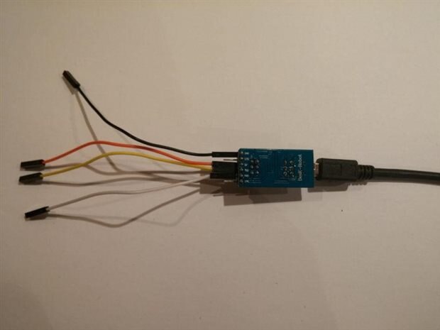

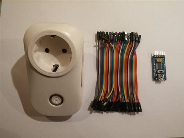

The ITEAD SONOFF S20 is a fairly cheap smart plug that you connect to a wall plug and then stick some device in it and you can turn on and off said device via a smartphone app for iOS or Android. But if you want to do the same (and more) from your computer you can install Linux on it. Buy a SONOFF S20 and a $1-$2 FT232RL USB To TTL 3,3V FTDI. You will also need a screwdriver, four Dupont wires, a solderling iron, some pins and a MiniUSB cable.

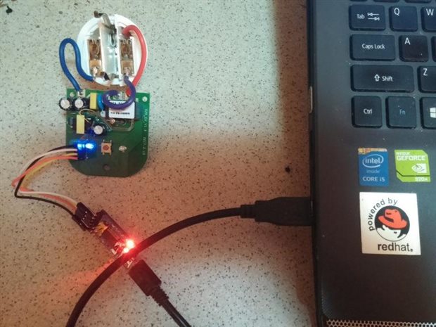

If the FTDI controller has a 3,3V/5V switch turn it to 3,3V. Do not use 5V for this. Connect the Dupont cables to four pins:
Black to”GND”, orange to ”5V”, yellow to ”TXD” and white to ”RXD”.

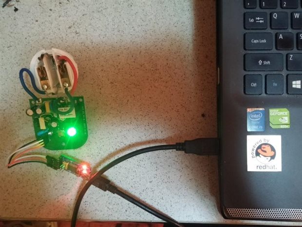

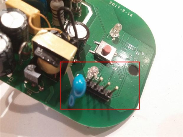

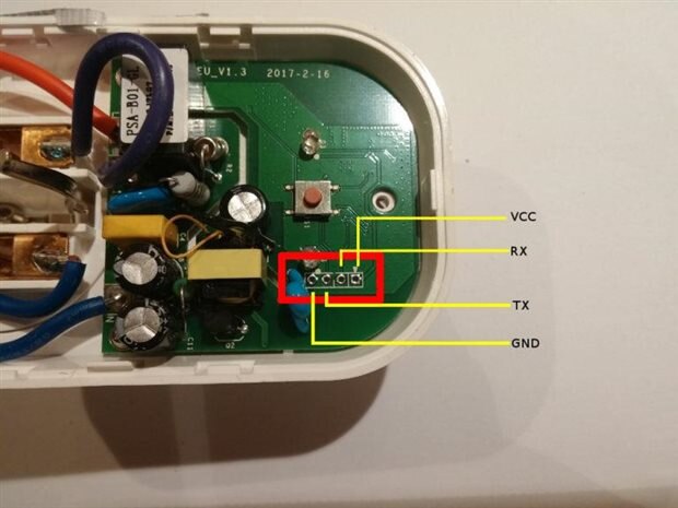

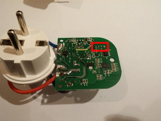

Now use a screwdriver to open up the smart plug. There's a screw under the label on the back. Inside, near the single button, you will find four holes.

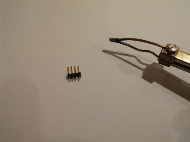

You will either need to solder a four pin connector to them or solder the wires directly to the holes.

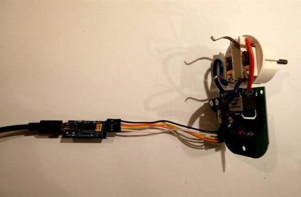

Assuming you opted for pins connect the other ends of the Dupont cables coming out of the FTDI like so:
  • GND to GND
  • VCC to 5V
  • TXD to RDX
  • RDX to TXD
Now plug in your USB cable into your Linux laptop. The green light of the plug should turn on.
Push the button on the smart plug and keep it pushed then take out the USB cable. Wait two or three seconds then re-insert the USB cable. Wait two more seconds and you can release the button pressure. The LED should have now turned blue, meaning the SONOFF S20 entered its programable mode.

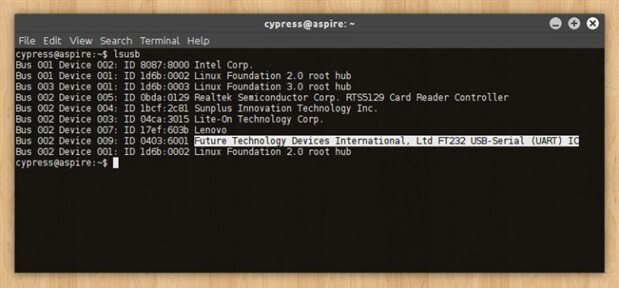

If you do a lsusb in your Terminal you should see the FTDI listed there:
Do a dmesg | grep tty in your console to see where exacly is your USB device located. In my case it was at /dev/ttyUSB0.

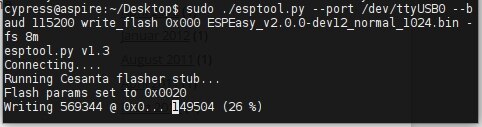

Assuming your USB device is on /dev/ttyUSB0 you can now write the firmware with
sudo ./esptool.py --port /dev/ttyUSB0 --baud 115200 write_flash 0x000 ESPEasy_v2.0.0-dev12_normal_1024.bin -fs 8m
Wait for the firmare to be flashed onto the smart plug:

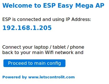

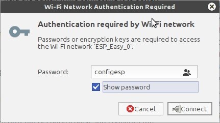

When the process is done you can now disconnect the USB cable and reconnect it after a second or so. A new WiFi network named ESP_Easy_0 should appear. If it doesn't just give it a couple of minutes to be read by your router. You can connect to this new WiFi network with the default password configesp.
Now open up a browser tab and enter the local IP address 192.168.1.205. A webpage looking like this should be now visible:

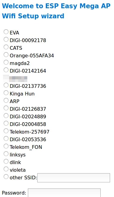

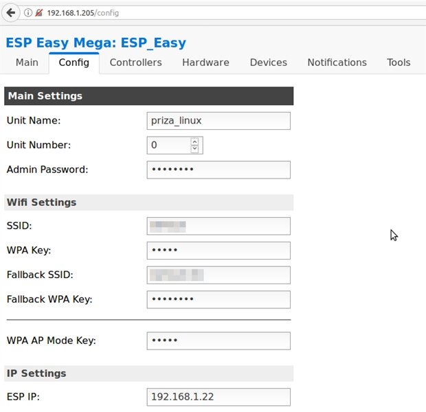

You will be prompted to connect to your local WiFi SSID and you can pick yours from a list of available SSIDs:

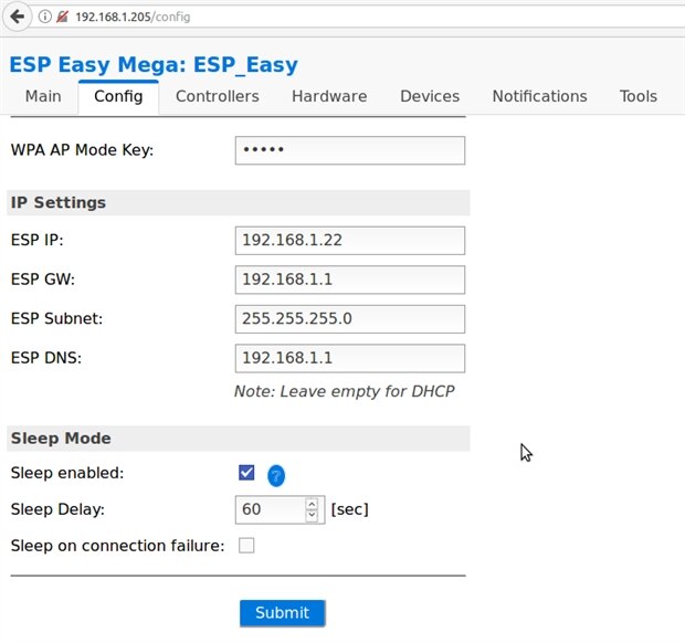

You can now configure a new IP address for the smart plug, one that is on the same network as your router. You can also give the Sonoff S20 a name so you can identify it on your Wireless network list:

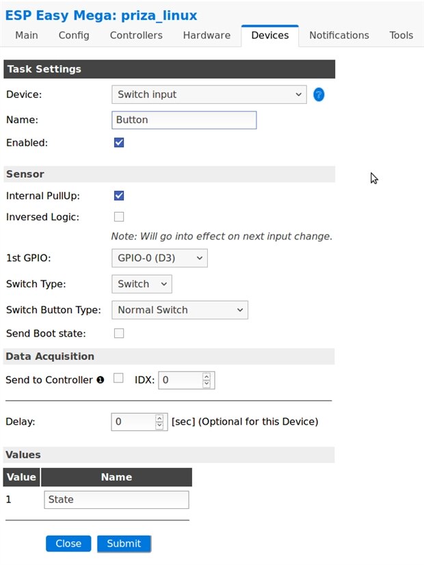

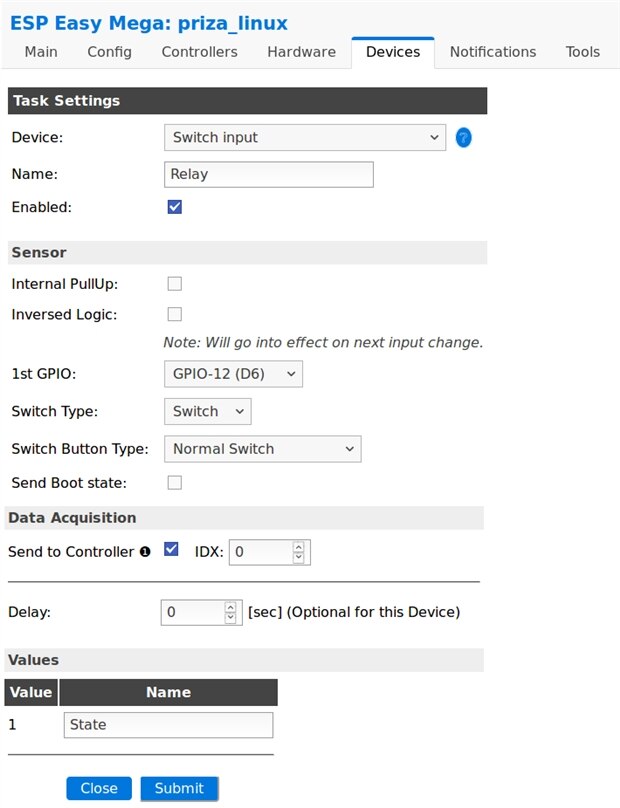

Switch to the Devices tab and make the following changes to it:
Click Submit then go again to the Devices tab and now create another entry that looks like this:

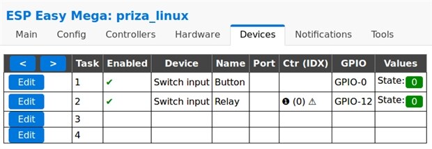

The setting window differs a bit in the new version of the firmware but you can write down the settings above and use them the same way. In the end you should have two entries like this:

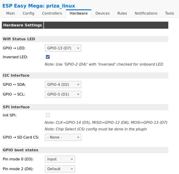

Go to the Hardware tab and make it look like so:

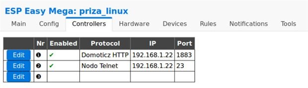

Add HTTP support and (optionally) Telnet support by configuring them in the Controllers tab:
