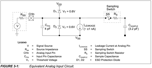

The conversion accuracy can be affected by the input signal source impedance when any external circuit is connected to the input pins. The source impedance adds to the internal impedance and directly affects the time required to charge the internal sampling capacitor. Therefore, a large input source impedance connected to the input pins can degrade the system performance, such as offset, gain, and Integral Non-Linearity (INL) errors. Ideally, the input source impedance should be zero. This can be achievable by using an operational amplifier with a closed-loop output impedance of tens of ohms

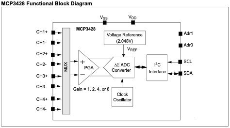

It's a switched capacitor input stage ADC as per this image in the datasheet:
But it also positions the PGA amplifier between the MUX (input channel selector) and the ADC circuitry which sort of implies low impedance already to the circuitry:
However, the sampling circuitry in the first image is actually encapsulated into the black blocks ahead of the MUX with the channel labels.  The MUX is allowing the sampling capacitor to discharge through the PGA into the Delta-Sigma convertor. So I will be using an OpAmp to buffer the ADC inputs - unity gain, with the PGA to provide actual gain - and, separately, as part of a compensation circuit for DAC outputs.  I will select for the ADC buffer, since that is critical, and use the same for the compensation circuit.  I think that this component choice is the one most likely to change depending on the downstream circuit that is being controlled (e.g. a DC load or sensor board), however I will select on the following criteria:

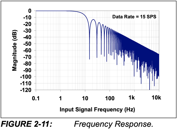

It seems recommended to front the analog input pins of the ADC with a low pass filter to attenuate noise.  The Sigma-Delta ADCs with oversampling do a good job of attenuating noise at the sampling frequency - this is the MCP3428:
At 15Hz the attenuation is quite pronounced; it's hard to tell but it might have reached the -3db level at 7.5Hz.  The recommendation is for a simple passive RC filter but the calculations for that don't seem to tie in with the ADCs need for a low source impedance.

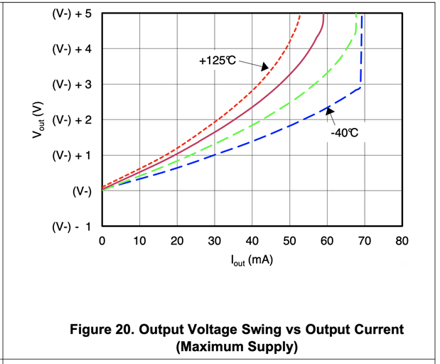

Also, the Op Amp performs best at low load: Vos typically 5mV at no load rising to 430mV at 2K and sinking again to 95 at 10K.  Except when Vos is characterised by output current (this is a 10K load):
This would imply a higher resistance would be better (for a smaller current) although it obviously isn't linear against load.  How a higher resistance impacts the gain, offset and INL of the ADC isn't clear either - the datasheet is quiet on the impact of source impedance against error.  In other words, this has me confused so the best approach I think is to characterise it with the prototype and try different configurations, as long as I provide some capacitive reservoir for the ADC and some resistance for the Op Amp.  I'll need to bear in mine settling time and time constants for any RC filter, plus the ADC internal RC filter formed from the switch resistance and sampling capacitor.
