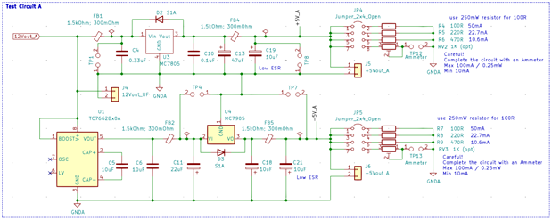

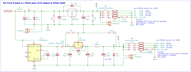

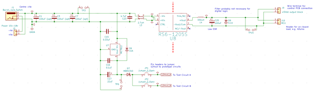

Following on from the first attempt which was moderately successful, Michael Kellett posted a schematic of how he has approached a multi-rail output using inductors - see the comments in the first iteration.  I decided it would be interesting to create a comparison between what I had drawn up, and integrating Michael’s approach.

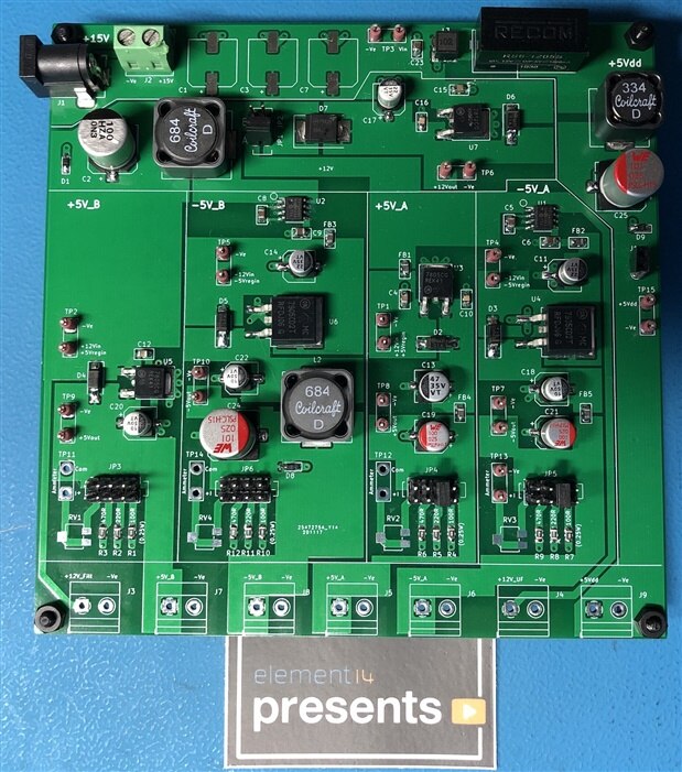

Schematic and PCB
In this iteration, I’ve made allowance to power either circuit A - my original approach - or circuit B - my approach, modified to use inductors.  I’ve jumpered the connection to circuit A and B so only one is active at any time.  I’ve also provisioned for different loads as well as a potentiometer to give a more varying load - these are also jumpered.  I can power the board from a wall-wart with DC connector (intended source), or from an external supply such as a bench supply or battery pack.  Optimistically, I've provisioned space to solder wire-to-board connectors in case it works so well I can use it moving forward!

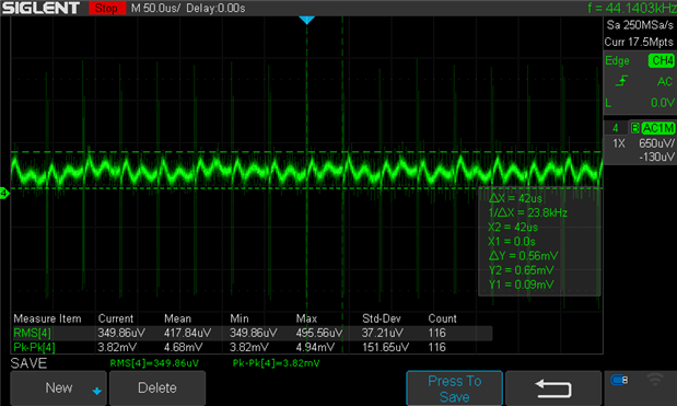

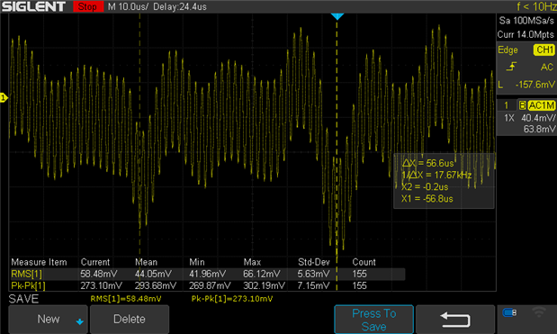

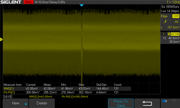

  • Layout is really important.  +5Vout on Circuit A doesn’t work very well (yet was fine in iteration 1.)  Although the DC levels are correct, the ripple is large and trying different capacitors on the 5V regulator made no difference.

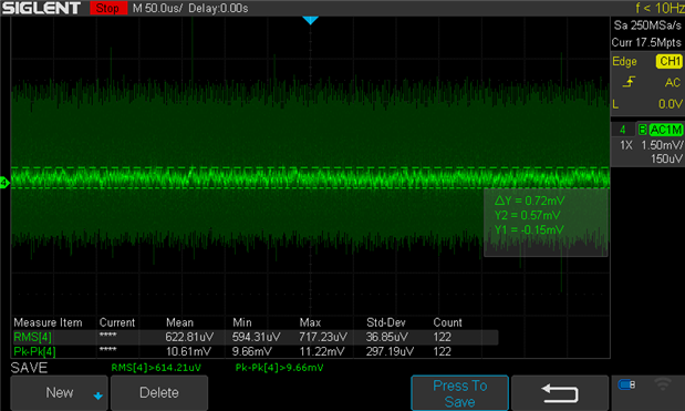

  • Circuit B, with inductors, gives a better result.  I played around with different capacitor values, removing/added components etc but this didn’t have a big impact on the output signals.
  • I had to spend a lot of time ensuring I was getting the probing and scope setup right.  The noise I’m measuring is quite small and the RMS is within the noise floor of the scope - I don’t have better equipment to amplify the signal or try and take (decent) differential measurements.  Even so, there is noticeable peaking on each screenshot below.  I’m not convinced it isn’t being generated by the scope or poor probing: if I try and take the same measurement with a different probe, different channel I can see large differences in the pk-pk values on some outputs (e.g. from 6mV down to 2mV.)  However, those spikes aren't there when I try a different power source - I get different noise signals as to be expected - so I don't know.  In any case, no matter what I tried, I couldn’t get rid of it or attenuate it in any way.
  • The RMS noise is uVs on all sensitive outputs (+/-5V) which I think is pretty good.  I'm making a bit of an assumption here of course, given I can’t properly measure a signal that low, but if the signal is in the noise floor rather than mVs it's an achievement!

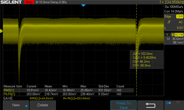

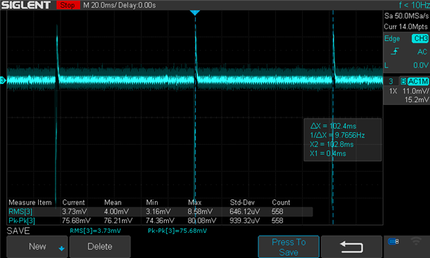

  • The 4Duino that is hooked on to the +5Vdd output is generating a large spike at around 10Hz which is being coupled back to the 15Vinput rail.  Fortunately, the linear regulators are filtering it out and whilst it is measurable in 10s of mV, it shouldn’t impact other components on that +5Vdd rail which are operating at digital levels, i.e. +5V or 0V.

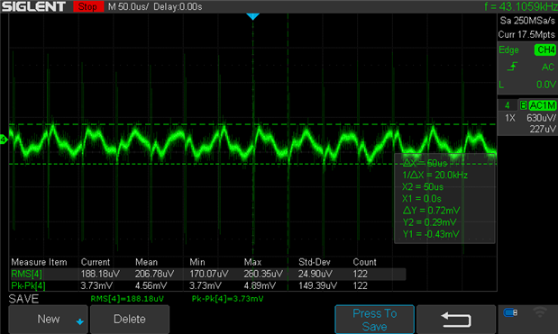

I'm posting a subset of images for interest - there are many more in the attached zip files.

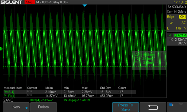

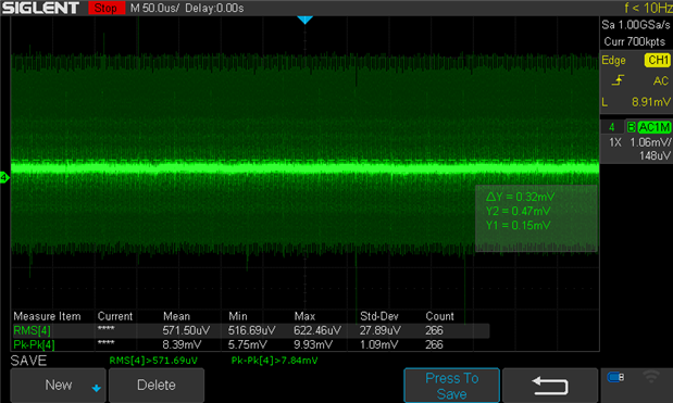

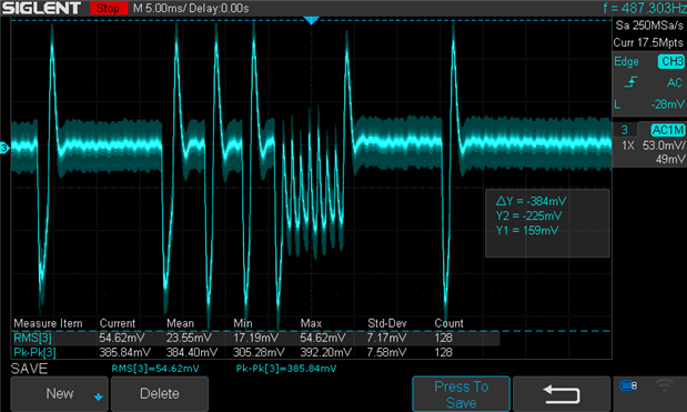

+15Vin: Large ripple and noise from the wall wart and reflected from +5Vdd rail through the DC-DC converter.  The large droop occurs at 10Hz (sometimes slower) and is generated from the connected 4Duino.  There's a better image of this in the +5Vdd shot.
+15Vin: A better view of the ripple

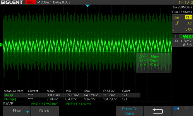

+5Vdd, this shot shows a particularly bad view of the noise generated by the 4Duino; typically those droops occur at around 10Hz but occasionally it's a lot worse.  The actual ripple is around 3mV when running smoothly:
Circuit A, +5Vout, truly hideous:
Circuit A, -5Vout.  Ripple's not bad, noise is peaky (if it actually exists):

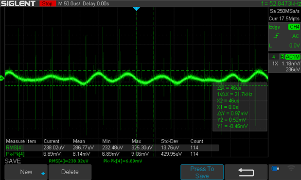

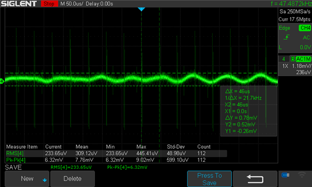

Circuit B, +5Vout:
Circuit B, -5Vout:

Circuit B, +5Vout
Circuit B, -5Vout
