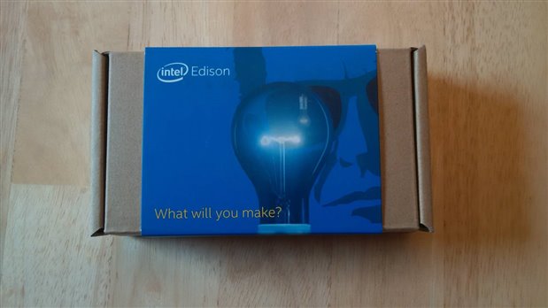

The Box:
Here is the box sent to me by my friend Dave (element14Dave). Edison has been out for a while and this whole review is late enough I doubt this unboxing will be too exciting for anyone. Here goes anyway.
