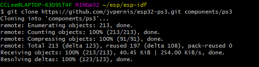

2. clone ps3 component to esp-idf.

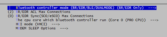

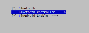

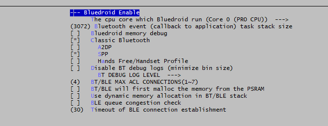

4. configure project. i may use different version of esp-idf with jvpernis. some options do not appear in my configuration. however, i skip those and it still works. my config as below
5. compile and flash into esp32 devkit

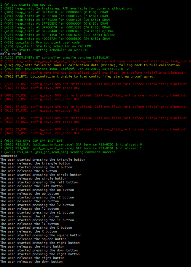

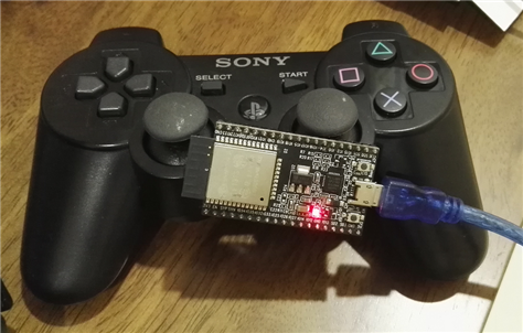

6. pair with ps3 and check serial output from esp32. It works!!
This is just the start of the project. My aim is to do this with arduino IDE. That will come later.

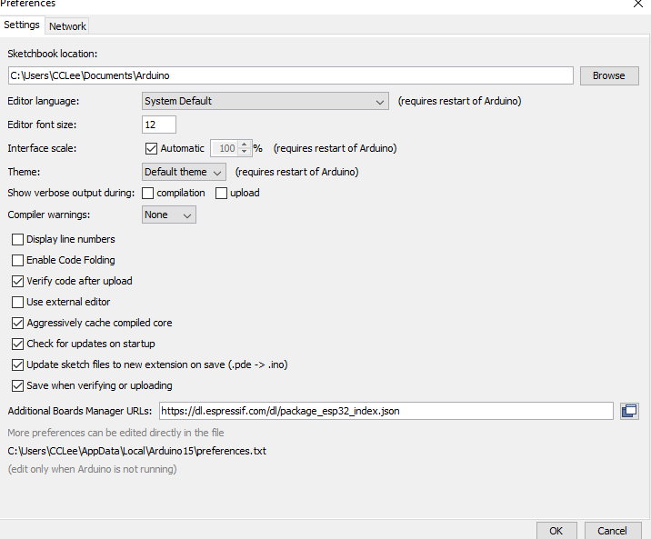

1. add package esp32 json into additional board manager

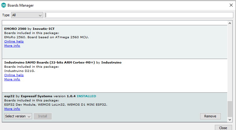

2. install esp32 board to arduino ide

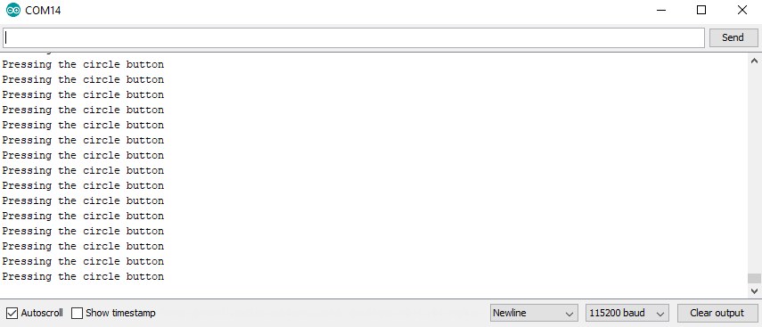

4. run sample code, it simply works! brilliant work from jvpernis!
