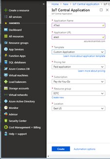

After you have selected 'IoT Central Application', you will be asked to confirm the Application Creation
Followed by the details for the Application:
Much of this is self explanatory but it is interesting to note that:
  • The application name will be used to generate a unique URL prefix so make it something that is easily remembered.
  • For the application template, use 'Custom application'

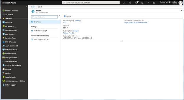

Then click Create.   Azure will then create and deploy your application and once it  deploys, it will show up in the 'All Resources' screen
After the newly created application shows up in the Resource screen, select it and you will be shown the details for the application:
Selecting the URL listed, will take you to the IoT Central Application where you can create a Device Template.
