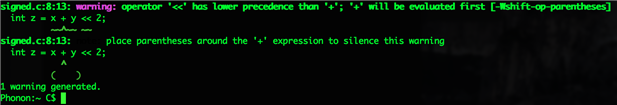

As a recovering math major, I like to think I have a good handle on how arithmetic operator precedence. You know, things like 4*5 + 10*5 and knowing that the multiplications will be performed first. C has a way of humbling all of us self-described smarty-pantses. Here’s an example that tripped me up recently:
int Z = X + Y << 2;
Now, I have this unfortunate habit of treating right and left shift operators (<<, >>) as multiplies and divides by factors of 2 in my mind. Thus, one would think the shift should be evaluated first, since it’s equivalent to a divide. In actuality, C puts a lower precedence on the shift operator than addition and subtraction. So X+Y is evaluated first, then shifted. Oops.
You can either try to remember things like this, or you can once again be explicit:
int Z = X  + (Y << 2);
Problem solved, and I think in a way that is far more readable. If you forget this one, you may be lucky enough to get a compiler warning (gcc did in fact warn me by default when I tried the first example, while IAR did not). Turn it on if you have it available, but also just put parentheses everywhere, they are free.
