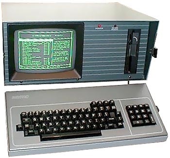

Kaypro 10
In June of 1983, Non-Linear Systems introduces the Kaypro 10, it shipped with one double-sided double-density (DSDD) floppy disk drive and a 10-MB internal hard drive. Currently, replacement parts for both the floppy and hard drive are limited to used items with increasing prices and questionable reliability.  Given the choice of maintaining the Kaypro 10 as rarely used museum pieces or continue its useful life as an example of what technology was like as computer begin to enter the home and small businesses, I have decided to replace the less reliable parts: floppy and hard drive with emulators that utilize solid-state technology (SD/USB), so it can be used by students to experience CP/M on an early example of personal computer.
