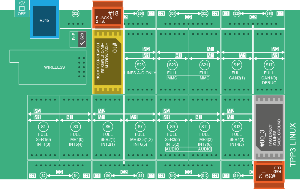

  • This is a simple application which enables the control of a GPIO line via a web browser. To toggle the line HIGH/LOW, click on a rectangle. This app can be used to control a relay Tibbit, a LED Tibbit, or some other "output" Tibbit.
  • The app utilizes a popular socket.io library to facilitate a connection without interruption between the TPS and the browser, as well as the AngularJS V1.x.x front-end framework that makes the development of single-page applications simple.
What you need
Hardware
  • 1 x Linux TPS3 (LTPS3) board, optionally in a TBP3 enclosure
  • 1 x Tibbit #18 (power jack)
  • 1 x Tibbit #10 (power supply)
  • 1 x Tibbit #39_2 (large red LED)*
  • 1 x Tibbit #00-3 (2 direct I/O lines with 5V and ground)*
*Feel free to replace the Tibbits with other output ones

  • Define the configuration in the LTPS Web Interface
  • Login to the LTPP3 board from the SSH client
  • Install NPM and other tools as required
  • Install the app:
git clone https://github.com/tibbotech/tps-gpio-tutorials
cd tps-gpio-tutorials
npm install .
cd one-led
  • Launch the app:
node server
