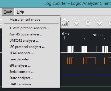

As client, I use the Logic Sniffer from jawi (OLS). I've tested it on Windows 8.x and on Ubuntu 12. It works fine in both configurations.
The above capture is showing the signals of the Arduino ShiftOut example, where the values of 'DS In' are shifted into a register by the clock on line 2, and the output on Q0 -> Q2 can be seen after the latch up at line 3.
In the image above, I'm shifting in the values 1, 2 and 3 - each of them followed by a latch.
The Logic Sniffer has a set of protocol decoders, e.g I2C, UART and SPI.
