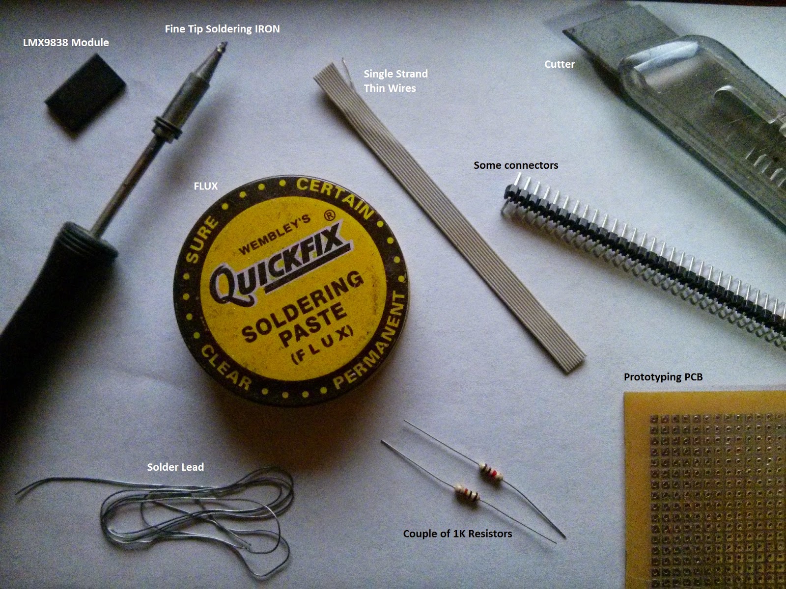

So the shipping will take approx 3-4 Days after order conformation, mean while, if you already dont have the required components, you will need the following :
Now that we have everything with us, LETS BUILD image
