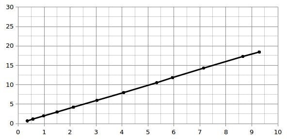

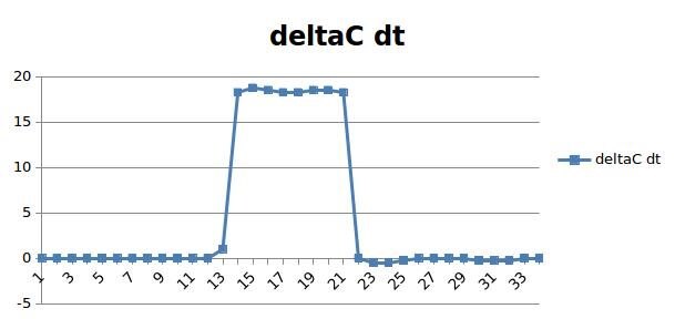

Constant wattage was achieved by adjusting the current to known values.
The most difficult task was getting an accurate temperature reading of the input interface.
It took a few tries, but i managed to sandwich the thermocouple wires between the resistor and PowerPeg.
Once everything was set up I tested ten different power levels, and divided the temperature difference by input power.
The Arduino was programmed to switch on the load, and record temperatures in 5 second intervals. The graphs looked like this:
The experiment was surprisingly accurate. I know there wasn't much error, because the calculated data was extremely linear across the power distribution.
