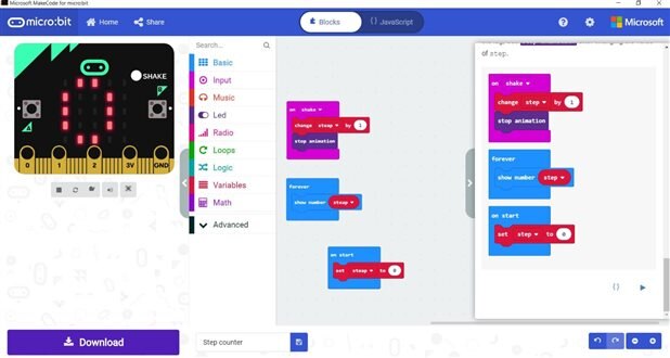

At the micro:bit code club here, we started with a basic example given in Microsoft MakeCode - the step counter (Also known as Pedometer) and from there we gave the students total liberty (and a reel of scotch tape!) to see what they could manage to track. And we were in for a surprise!
Step Counter
Above are some of the codes the students tried out for the step counter. One notable thing is that MakeCode gradually moves from giving full blown tutorials to giving instructions and letting students figure things out on their own. The students tried out the step counter, and the watch example, and then combined the codes to switch between the two with the press of a button. The step counter registers a step in response to a shake movement - In a normal micro controller with an accelerometer or IMU like the MPU6050, one would only get raw X,Y,Z acceleration values or at the most - roll, pitch and yaw. It is simply impossible to count repetitions of movements that way unless you see the peaks in a graph and make use of some machine learning algorithm- which is way beyond the scope of what we are trying to do here! But fortunately for us, its very easy to trigger the micro:bit to respond to movements such as tilt left, right, logo up, down etc as seen in the below image.
