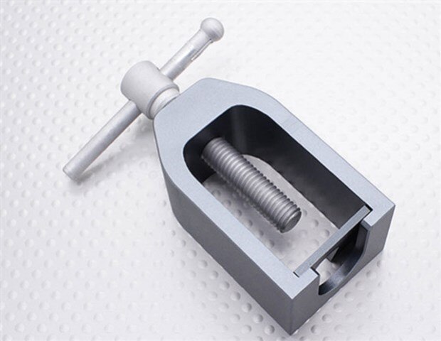

    Hi Dubbie, Wow, interesting find. They are tiny! For larger motors there are 'pinion remover' tools, but perhaps they are not available for such a small size. The photo below shows the idea, the plate…

    shabaz over 7 years ago
    Hi Dubbie,
    The photo below shows the idea, the plate at the bottom needs to fit between the object to remove and the motor, and then the screw thread pushed against the shaft end.. so in theory the motor itself never experiences any force. Perhaps the plate could be replaced, and a small hole drilled in the thread to push a 0.6mm shaft from one of the broken motors.. but is a lot of effort : (
    I'd be tempted to buy a cheap pair of pliers, and see if they could be adapted (using a dremel and a cutting wheel) to convert them into a similar thing. But, that's still a fair amount of effort too : ( I guess in terms of time it could be simpler to just take the hit that a few motors will be lost in the removal process! : (
