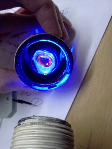

Hey folks! Just a quick peep from yours truly here to give y'all a quick insight into the hectic last-minute tinkering of the BioBoard team. We're now 2 days, 23 hours and 38 minutes from the GGHC 2011 dead-line - that'll be Tuesday 3rd May at 00:00 hours - and officially in crunch mode. The project has shaped up really nicely in the last week - the two thermal sensors are finished, have been successfully wired up to Arduino boards, as has the NIR probe, and we've had live data transmission and graphing from the home-built digital thermometer. Rolf has also succeeded in bulding a pH amplifier circuit that let's us use a regular aquarium pH probe with our Arduino board. Otute unfortunately couldn't make the last meeting, so we've yet to see whether his home-built electrodes will work with the amp circuit. As for the dissolved oxygen sensor, we've come up pretty square against the same consistent problem every time, namely getting the dissolved ruthenium ion to form an even film across the mylar sheet. Surface tension keeps pulling all the solvent to the edges of the little glue enclosures (see the picture below), and Sean has been forced to go out of town on work, so it looks like we're going to have to accept that we won't make this happen before the dead-line. We're close enough to be fairly pleased with the collective effort nonetheless - I've taken a look at our original goals as stated in our project overview wiki:

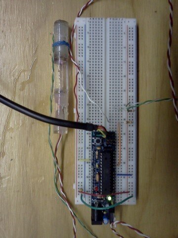

The NIR probe wired up to a BoArduino

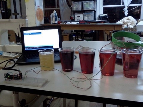

The NIR probe calibration setup - the glass beaker on the left contains green tea kombucha, while the cups contain a dilution series of Hibiscus extract.

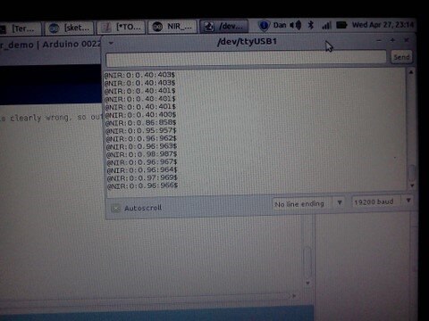

Data from the NIR probe - the difference in optical loss between the kombucha and the darkest Hibiscus tea is 56% - pretty neat!
The oxygen probe, painted black inside to minimize internal reflection of the flourescing ruthenium complex - the uneven distribution of the film is clearly visible.

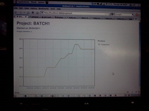

Real-time graph of data from our home-built digital thermometer!
