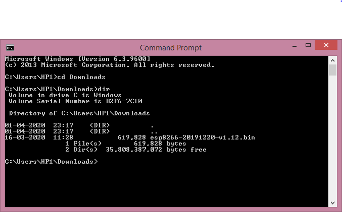

>> Finding your MicroPython .bin file
By default, the downloaded file will be saved in downloads folder on your C: drive
Find out exactly where it is. So, with your Terminal window, you’ll need to navigate to the Downloads folder using the cd command:
cd Downloads
dir
As seen above, it is located at Downloads folder: esp8266-20191220-v1.12.bin

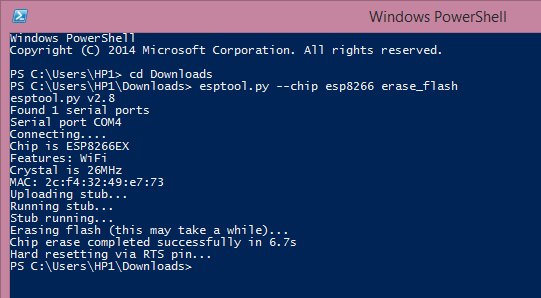

>> Erasing ESP8266 Flash Memory
Before flashing the MicroPython firmware, you'll need to erase the ESP8266 flash memory. So, with your ESP8266 connected to your computer and hold down the “BOOT/FLASH” button in your ESP8266 board.
Type the below commands on your Command Prompt or Powershell window in Downloads directory.
esptool.py --chip esp8266 erase_flash
When the “Erasing” process begins, you can release the “BOOT/FLASH” button. After a few seconds, the ESP8266 flash memory will be erased.

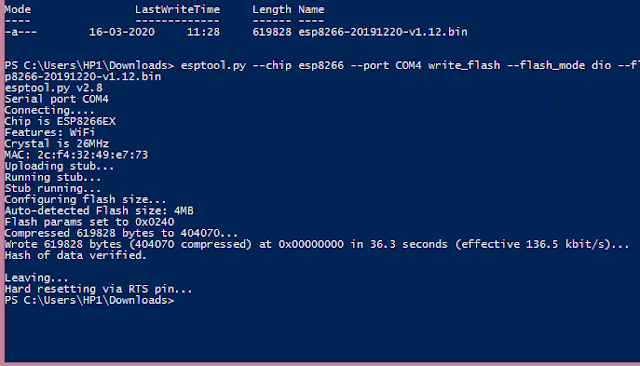

>>Flashing MicroPython Firmware on ESP8266 with esptool.py
With your ESP8266 flash memory erased, you can finally flash the MicroPython firmware. You need to replace with your serial port name (Ex :COM4) and the ESP8266 .bin file location (Ex : esp8266-20191220-v1.12.bin) in the below command and execute the same in your Command Prompt or Powershell Downloads directory.
esptool.py --chip esp8266 --port <serial port> write_flash --flash_mode  dio --flash_size detect 0x0 <bin file name>
Hold down the “BOOT/FLASH“, before running the flash command. After a few seconds this is what you should see :
Ended up with this ? Congradulations ! You're all set up to play on your ESP Tool with MicroPython fully loaded.
