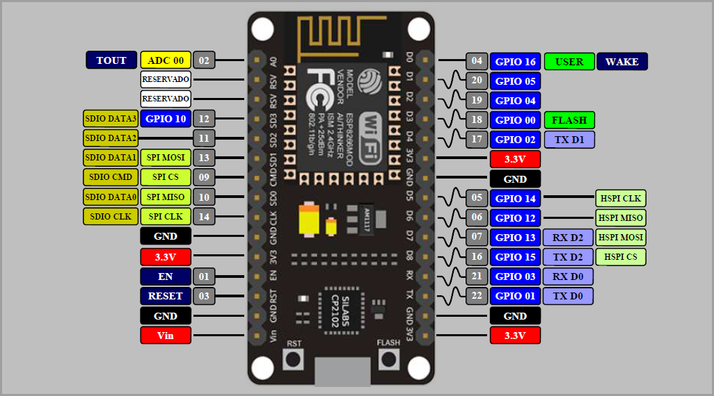

Implementation on ESP8266 (NodeMCU)
Using MicroPython PWM can be easily implemented and you will be able to get signals with different duty cycle based on frequency and delay set. Let's go through then !
The algorithm goes as follows :
> Import the Pin on the device to your program using 'from machine import Pin'.
MicroPython says, " Hey Pin 2 there on ESP 8266, someone is calling you. Come on! "
Also, call PWM class here with 'import pin, PWM'.
> Call the time
" Hey clock, help me in knowing the time/delay ".
With the help of time, you can turn LED on and off. Call time with 'from machine import sleep'. time.sleep(<delay>) is used to set delay.
> Set frequency for PWM cycles with 'frequency = x' and then set Pin number and call frequency as declared above.
> Now, it's all about repeating the cycle. We have already set factors and made declarations.
for i in range (<initial>, <final>, <step size>):
Here, we'll need only <final limit> and <Initial value> in these 3 factors and others will be taken '1' by default. Giving a range of analog values, 0-1023+1 (10 bit) within a for loop, ranging will be possible with default intervals of 1.
Putting these functions in while loop, it will be possible to visualise Fade in LED attached to Pin 2.
Below is the MicroPython script for the same:
from machine import Pin,PWM
from time import sleep
frequency = 5000
led = PWM(Pin(2), frequency)
while True:
     for duty_cycle in range(0, 1024):
       led.duty(duty_cycle) sleep(0.005)
Get this written and run the script. There there !
You will find Pin 2 LED fading with declared Interval. Try changing interval, frequency, delay and you'll find something interesting !

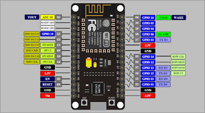

LED with Minimum and Maximum Brightness
LED's can also be attached to any of the other GPIO's and the same function can be achieved in 10-bit resolution. Change the Pin number (line4) of the source code
The pin assignment is in the format GPIO(x) and not Pin(x) of ESP8266.
(Ex: Pin 17 (D4) is GPIO 2 which we declare as Pin(2) in code)
