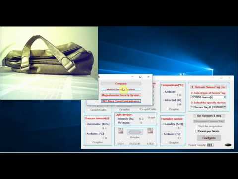

  • you are at an airport and you have to wait 4 hours until your plane leaves;
  • under these circumstances, you decide to finish the presentation that you just have to sustain tomorrow, or why not, to watch the last episode of your favorite movie.

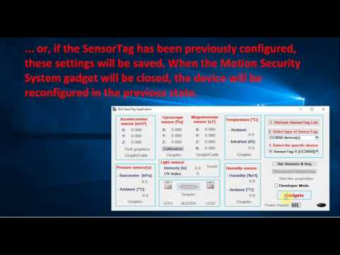

  • pair with your laptop,
  • start the Motion security system gadget’s application, and
  • take care of your activities without any concern.
     The problem is solved! If someone moves, even one centimeter your luggage, the app will warn you audio and/or visually of this fact … and the thief will be caught.

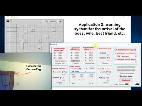

Application 2: warning system for the arrival of the boss, wife, best friend etc.
This application,  blessTags (BLE SensorTags) application, can be downloaded from the Windows Store Apps: https://www.microsoft.com/store/apps/9p054xsjjr1n.
