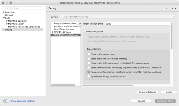

Step 2: Change Erase Options
I found changing to “Replace written memory locations, retain unwritten memory locations” or “Erase and download necessary segments only (Differential download)” kept the FRAM intact. I would like to understand each of these options in more detail, but that will have to wait.

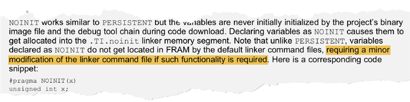

This step really irritated me. TI has gone out of their way to hide this critical change. In the application note "MSP430TM FRAM Technology – How To and Best Practices", they outline how to "properly" use FRAM on an MSP430. Except, the document really does not. At least in the case of preserving FRAM contents during re-programming. In section 5.1, it describes NOINIT and PERSISTENT. However, it brushes off a key step for NOINIT with the following comment.
"Requiring a minor modication of the linker command file is such functionlity is required." What?!
If you study the document closer, it infers the changes needed to be made to the "linker command file." However, it never clearly states WHAT. Also, the disturbing aspect is that it is a single line of code. In most of the forum references, the closest correct answer I found was, "...read the linker user's manual."

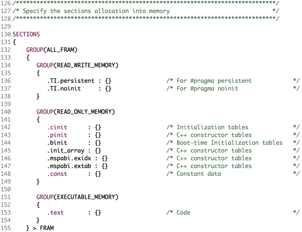

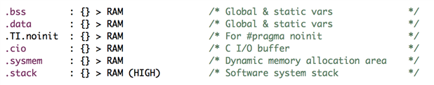

The "linker command file" is generated by CCS automatically for your processor. In my case, it is the “lnk_msp430fr2633.cmd.” Inside appears to be the memory map the linker uses to put variables into a memory location. Search for ".TI.noinit," to find it in the RAM definitions.
Comment that line out and them scroll back up to the line marked "SECTION." There if you look at the structure, it is groups called things like "READ_WRITE_MEMORY" and "READ_ONLY_MEMORY."
Here I added the line at 137. It tells the linker to place "NOINIT" variables into FRAM and that they should be READ and WRITE capable. That's it.
