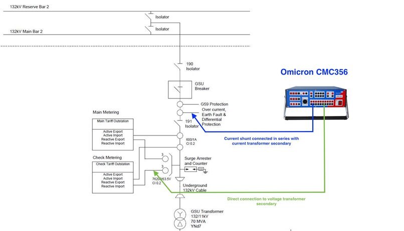

I have used both Hioki 8808 HiCorder as a standalone data recorder and an Omicron CMC356 in conjunction with Enerlyzer software to record the energisation of transformers and the operation of automatic voltage regulators and synchronisers on turbogenerators. I also utilise Iris TGA-B and RFA-II data collection units to monitor and analysis the condition of generator stator and rotor windings.
Predominantly these data recorders are connected onto the electrical systems on the secondary side of current and voltage transformers and then reconfigured to display the primary values they are recording. In the majority of instances, the data recording is initiated manually, based upon the activity within the plant. Below is a typical connection scheme for the Omicron CMC356 to monitor the energisation of a transformer.
This is what the connections look like in practice. On this occasion current clamps were used instead of current shunts.
The initial results are saved in the bespoke Enerlyzer software and can be analysed in basic format as seen below. Further analysis is carried out by exporting the files in a Comtrade format for analysis in specialist protection software such as ABB Win or more generalised software such as Matlab.
To record the data, the Enerlyzer would be setup and initiated manually, just prior to the main breaker being closed.
