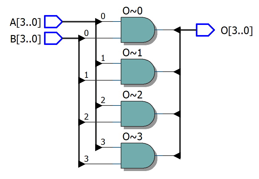

module ic_74F08 (A,B,O);
  //input output decleration
  input [3:0] A;
  input [3:0] B;
  output [3:0] O;
  //internal connection
  assign O = A & B;
endmodule
The module_name is ic_74F08 which has inputs A and B and output O. The only connection is done by assign keyword. Assign is the continues assignment statement. It is used only for modelling combinational circuits. You can also use logic gates which are described in Verilog functions. In that case, assign O = A & B; should be replaced by and(O,A,B) which is gate level modelling.
The RTL view of the design is the same as the datasheet of 74F08.
