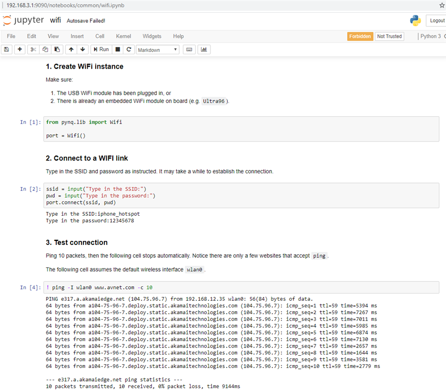

After connecting up my Ultra96-V2 board to my work PC using a USB-micro cable and powering up with the fresh PYNQ SD card inserted, I used the built-in Jupyter notebooks to configure the WiFi onto my wireless network so that I can do all of the development work from my work PC via SSH:

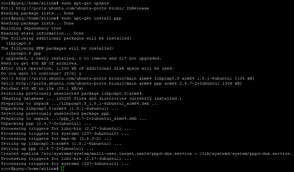

The ppp package and dependencies are also needed, so those are also installed with apt-get package manager:

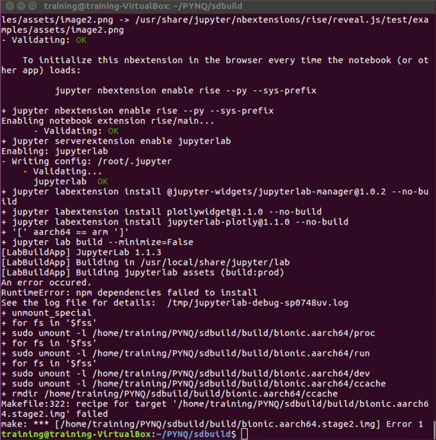

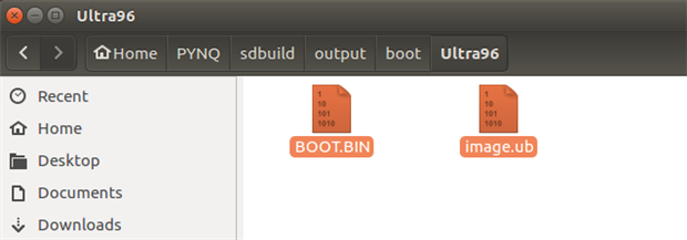

After waiting for quite a while, it turns out that the PYNQ build ultimately fails during the jupyterlab build step.
Looking a little closer, it looks like most of the build steps completed, including the Linux Kernel build step, and even the BOOT.BIN and image.ub files are built and sitting in the PYNQ/sdbuild/output/boot/Ultra96/ folder which are all that are really needed to get the updated kernel anyways.

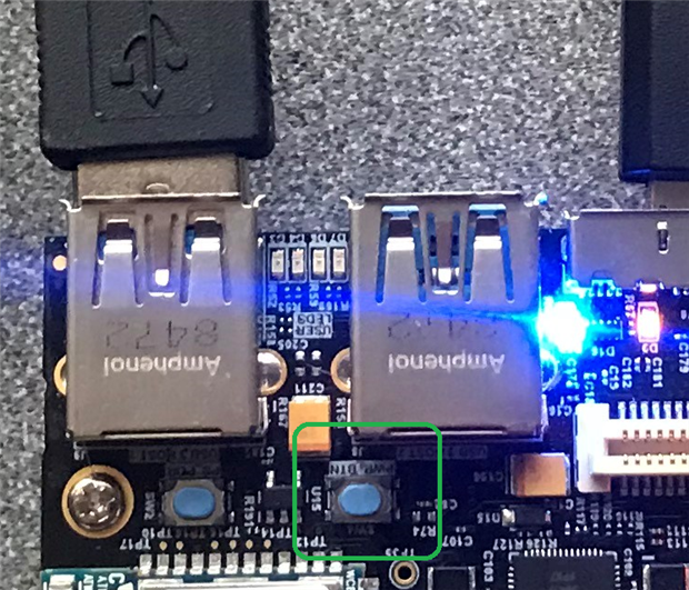

Next, I shutdown the Ultra96-V2 (properly using the shutdown -h now command or pressing the SW4 power button once).
Now copy these two newly built files over to the FAT32 partition on the SD card, overwriting the existing BOOT.BIN and image.ub files on there.

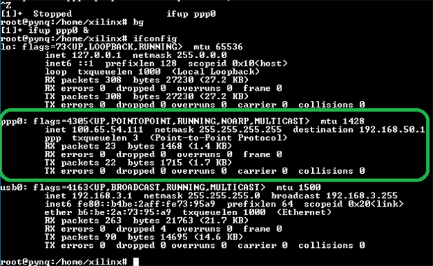

After powering up the Ultra96 with the updated BOOT.BIN and image.ub files on the PYNQ SD card, let's try to launch the ppp0 interface again, this time as root so that we can see the pppd debug info in the terminal:
The fact that an IP address was returned and DNS servers resolved is a pretty good sign. Used <CTRL-Z> then bg command to put that process into the background so that the networking configuration can be verified with the ifconfig command.
Then send some traffic to a preferred test site to verify satisfactory LTE-M connectivity:

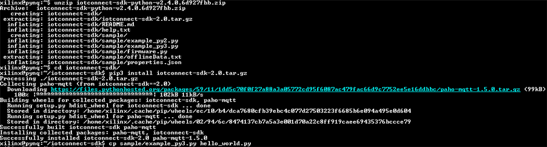

The folks in the Avnet IoTConnect team pointed me to the easy to use IoTConnect SDK Python client for the device side programming.  After configuring a few variables to match the IoTConnect account details I was assigned, I had some test data posting from my Ultra96-V2 board pretty quickly.
First, I downloaded the IoTConnect SDK for Python to my Ultra96 board and extracted the contents of the archive:
unzip iotconnect-sdk-python-v2.4.0.6d927fbb.zip
Then change directories into the unpacked iotconnect-sdk folder and install the iotconnect Python libraries and dependencies:
cd iotconnect-sdk
pip3 install iotconnect-sdk-2.0.tar.gz
Not wanting to corrupt the original example code files, I copied the Python 3 example application over as my hello_world.py application for when I start modifying the code to fit my Smart Cities application later on.
cp sample/example_py3.py hello_world.py
