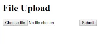

which results in;
You will notice that {{status}} and {{filename}} do not show up. This is due to them being the data that handlebar is looking to have passed to it by the server.
The other important part of this file is the enctype of the form, this needs to be set as multipart/form-data for the file uploader to function, we have also set the name of the file input to 'myFile', just as we told the uploader it would be. The destination is also set to be '/upload' and being sent by POST request. Now that we have a web page to serve, we can handle the incoming file.

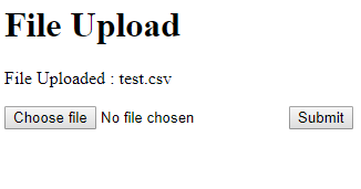

It starts out by checking if a file has been sent in the request, if it has it will log to the console the name of the file, and set the value for two variables which will be used later. One is the name of the file and the other is a status string. If there is no file, it again sets the two variables with a string indicating the failure of the upload.
fs.unlinkSync(req.file.path)
this removes the temporary file form the file system
the last part is the exciting bit, this uses the same template as before, but passes some information onto it. This information is then displayed in the field we specified earlier in the template. first we specify the field name from the template and then the data we wish to pass on, in this case the two variables we wrote when checking the upload. This results in the page being displayed as
Success!! we have a web page which uploads a csv file. Now to parse the file and display it as a table.
