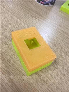

I've been looking for a reason to build something IOT for a while but never had a good enough reason. A number of things have blocked me, namely time, and a lack of electronics knowledge. Fortunately working with people who have the experience makes it easier and all I needed was an idea.
*Enter stage left, my Grandma*. Irene now lives on her own and generally gets visitors but she has a habit of ignoring the phone on a morning. This worries all involved and usually results in each sibling calling the other to go check she is up and about. I quickly realised we could help with this problem with a little bit of technology.
Both myself and guys in the office threw the idea around of a PIR connected to Raspberry Pi which seems like a good idea, apart from the cost. I wanted to keep the cost below the £10 mark and have the bare minimum hardware to run it.

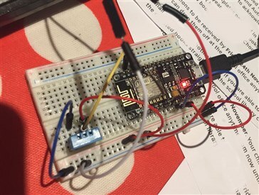

Note that if you have the v3 board, you will be lucky to get it on the breadboard. I actually settled for the row of pins that I use the most to be on the breadboard and have the rest hanging off the edge.

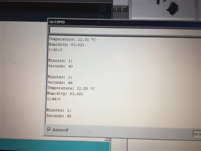

Writing Editing code in Arduino...
I am no stranger to code so this should be the easy bit, turns out that is pretty much correct. Apart from a few syntax issues I am now in a relatively familiar environment but unsure where to start. A helpful colleague shows the the example sketches menu which really blew me away and started me off on the right path.
This just popped open a sketch which output a ton of information in respect to the DHT11 (which we added to the PIR project Just for Fun). From here I can see pretty much how to go forward, setting up variables, working in the loop etc. Setting pinMode I/O. I pushed the code to to the NodeMCU, open the Serial Monitor and all looks good. Below is my slightly modified version of the boiler plate code.

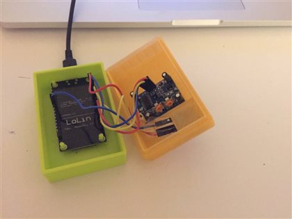

the output initially looked fine but the PIR felt a little twitchy, sometimes it seemed to work and other times it didn't. I played around a lot with this but I wasn't confident in the results I was getting. In fact it was so sensitive I thought it was pretty unusable.
Fixing the false positives on the PIR
I got pretty frustrated at this point but while frantically reading blog posts I found that the HC-5201 has a voltage regulator on the board. The HC-5201 board is 3.3V and can take 5V in stepping it down for the PIR circuit and apparently you could bypass the regulator as the NodeMCU is 3.3V and the theory was that the regulator was interfering somehow. The trick was to place the +3V on to the spare jumper on the PIR when in short mode. I had varying results with this but it was more favourable than soldering a wire on to the back of the voltage regulator to bypass it. I was quickly out of my comfort zone as I know very little about electronics, enough to be dangerous, so I wrote this off as an ineffective 'fix'
Luckily I have came across a project that used the DHT11 and an PIR and which used a pull-up resistor on the DHT11 (I wasn't sure why). I decided to add the resistor and everything started to work as expeted. It seems the 4.7Kohm pull-up resistor was the missing link and if you look at the DHT11s that you can buy on PCB (with connector), you will notice a small thin film resistor on the board between the 3V3 and DATA OUT.
There is also a capacitor which could solve another problem where the sensor errors out intermittently. My theory here is that when the two devices are polled at the same time this impacts the voltage somehow and the DHT11 drops out. Tweaking the timings of the read on the DHT11 addresses this somewhat.
The end result was similar to the image on the right and with the device working I could move from the hardware to the Internetting of the Thing.

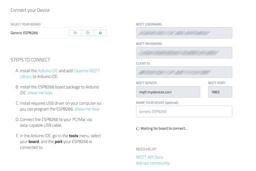

Connecting to the cloud (Cayenne IOT)
There had been a bit of chatter in the office about MyDevices (I will refer to this as Cayenne for the rest of this post), for connecting IOT to the cloud so I didn't really search around for other options and went in with no real expectations. Going from what I understood it seemed that you set up your device and most things automagically configure. I think that is possibly the case with the Pi but not so much with NodeMCU, that said I found the process pretty straightforward. And even uncovered how to auto register my device and sensors without the dashboard.
Cayenne allows you to create a device with the generic type of ESP 8266, there are also some useful links to the docs and github for all the things you will need for the Arduino IDE. I initially just went through the 'Hello World', which connects the Board to the service and walks you through the creation of a push button to light up the LED.
All the sketches are installed within the IDE and this is more than enough to get started. I chose the MQTT boiler plate as my start point. And quickly managed to light the onboard LED via the dashboard and my phone using the myDevices app (minutes of fun).

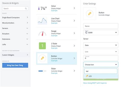

Pushing input to the device
All that is needed here is to add your device and install the libraries, take note of the 'username', 'password' and 'client id'
You then get directed you your dashboard, where you can add a device/widget, go to Custom and add a button.
You will end up with a button in your dashboard something like the following, (click on the settings icon/cog).
The really important parts are the Channel and I/O, the channel is what you use to I/O with the board. Or in this case just Input. Next we need to get the board connected. This is where you insert your credentials in to the new sketch and define the LED pin. On my version of the board this was D4.
The boiler plate already contains the code to connect, and we are not doing anything in the loop other than enabling Cayenne to access it via Cayenne.loop. The I/O is done in the last section of the code.  You can see the parameters to expect as 'request.channel', 'getValue.getId()' and  'getValue.asString()';
All that needs to be done is check for the correct channel, in our case this is channel '0', then we simply use digitalWrite to flip the state of the LED. If all goes well this should now be turning on and off the onboard LED. For me this was enough of an orientation to start pushing data to cayenne after looking at a few more examples.

  WiFi.mode(WIFI_STA);
  WiFi.disconnect();
  int n = WiFi.scanNetworks();
  // Check for valid networks
  for (int i = 0; i < n; ++i)
    if(WiFi.SSID(i) == "SSIDNAME1") {
      Cayenne.begin(username, password, clientID, "SSIDNAME1", "pass");
    } else if(WiFi.SSID(i) == "SSIDNAME2") {
      Cayenne.begin(username, password, clientID, "SSIDNAME2", "pass");
    } else if(WiFi.SSID(i) == "SSIDNAME3") {
      Cayenne.begin(username, password, clientID, "SSIDNAME3", "pass");
    } else if(WiFi.SSID(i) == "SSIDNAME4") {
      Cayenne.begin(username, password, clientID, "SSIDNAME4", "pass");
  // The rest of setup goes here
With the code ready I had to think about putting the device insitu at my grandmothers house, which meant it needed to be in an enclosure. So I stared to cobbled something together using what was lying around the house. The Cereal packet was my favourite but it wasn't really going to stand up (literally) but we had a 3D printer in the office and the guys in my team said 'we' could make a case.

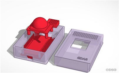

Designing the enclosure
Naturally that 'we' meant 'I' could design it and they would print it image, Chris and Phil we really helpful but the challenge was on to use CAD (another thing I have never done before). I looked at a few CAD applications but hit on TinkerCAD which is web based, I was hoping I could find a design and tweak it. I didn't have much luck but once I started using it I found it quite addictive. So with some pretty rudimentary tools (a ruler,  pen and paper), I measured up my components and mocked the whole thing up in TinkerCAD.
It took a while to get going but the tutorials helped a lot and I ended up with something that would help me play around with size and position of the box with the items in it. You can view the model ESP826 Enclosure here.

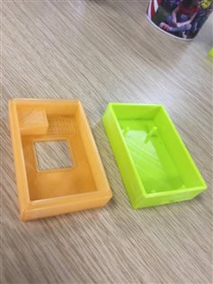

A fair amount of effort went in to this and on the first print I had some trouble with the small shelf I have made for the DHT11 and the small lip I made for the lid to insert nicely in to the base. This was because of the tolerances of the LulzBot 3D printer. In summary if I made any protrusion in the design smaller than .4mm the printer would not be able to include it in the construction.
I made a few tweaks to the measurements, which is actually easier if you reverse the construction and use the parameter and positioning tools, I made a quick youtube video to give an example of using parameters to build a base and lid with an insert. This should give you a feel for how it is approached.
Final files:
https://tinkercad.com/things/aRihn3YoLTe
https://tinkercad.com/things/65y468Q5onI
The end result was successfully printed in about 4 hours and everything fitted perfectly which is astounding considering I didn't use  measuring callipers.
The end result
The device is now in it's correct location and tracking data, which my parents can view over the web. There are alert features which can notify if movement is detected but unfortunately they are not really sophisticated enough for me to alert without sending a storm of emails and texts, but the graph is good enough for now. Perhaps as a next step I will look in to a web app which will aggregate the data and give a better view of the data collected and send alert that has more meaning.
