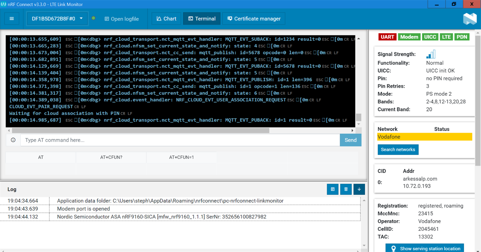

I checked and rechecked that I had loaded the right firmware to the Thingy:91, making sure I also had the latest version of the modem firmware. I used the LTE Connect software to communicate directly with the Thingy:91's cellular modem using AT Commands. I could see that there was a Vodafone signal available, but nothing I tried seemed to work. It is always hard when you are using a device and software that you have never used before to know what to expect, but it just didn't seem right. So I arranged a debug session with the Arkessa helpdesk. We spent another hour getting nowhere and they concluded that, actually, my signal wasn't good enough. That wasn't what I wanted to hear, having just spent £60 on what would be a pack of useless SIMs.  So, I found out where the nearest Vodafone cellular tower is and went out in the car with my Thingy:91 and laptop, so see if I could get a better signal. Nope!

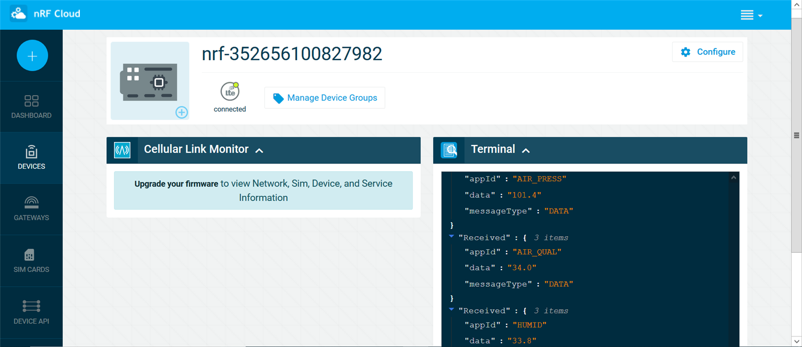

Later that evening, the Arkessa helpdesk guy emailed me to confess that, having checked, they had not provisioned my SIM cards properly (but had now fixed it). So, I tried again, and this time everything burst into life and I was streaming data immediately. Here is the proof.
Fair play to the Arkessa guy for following it up and checking (it was around 7:00pm on a Friday evening by then), but somewhat annoying that I had wasted several (more) hours.
Everything is not perfect, however, as the dashboard on nRF Cloud does not seem to be rendering the data in graphical form, which is what I was expecting. The data is coming though in JSON format as you can see in the right-hand panel, so that's a good start. The suggestion to upgrade my firmware must be bogus advice. I have logged a ticket on the Nordic Devzone, and await a response.
