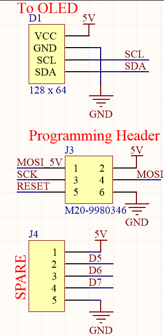

3.3 I/O
With the Integrated circuits chosen and it was simply a matter of connecting the inputs and outputs. We had selected an OLED with an I2C driver incorporated, this made interfacing with the ATMEGA very easy with only two pins being used as shown in Fig. 1.3, however it wasn't all plain sailing as we will discuss later. There were two other main IO blocks, a 2x3 header to allow the bootloader to be burned onto the ATMEGA chip and an additional empty header to allow for later modifications, such as a Bluetooth module or a speaker.
Figure 1.3 IO headers
