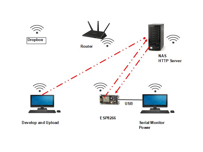

In order to test the system properly, I have used two PCs - one to power the device and display the device output on the IDE Serial Monitor and the second for Sketch modification and uploading to the HTTP Server.

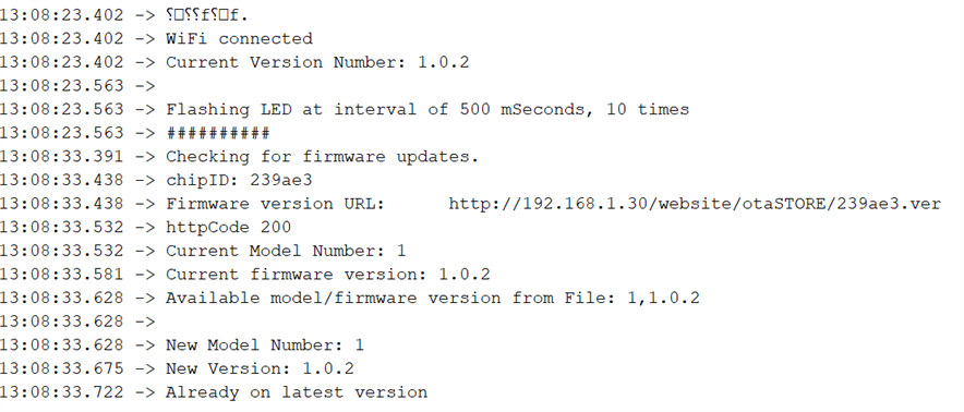

And here is the output from the demonstration sketch, where there is NO update available:

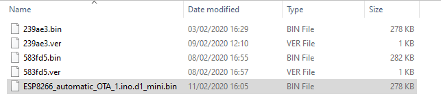

At the top of the IDE we now click on Sketch and then select Export compiled Binary. This places the compiled binary file into the same folder as the sketch .ino file
If the .ino file has a name, say, ESP8266_automatic_OTA_1.ino, then the compiled binary (in this case) has a name of ESP8266_automatic_OTA_1.ino.d1_mini.bin.
The compiled binary file can then be copied to the appropriate location on the HTTP server - in my case the folder is called otaSTORE

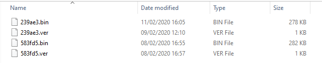

The device I am working with is 239ae3, so I now delete the 239ae3.bin file and rename ESP8266_automatic_OTA_1.ino.d1_mini.bin to be 239ae3.bin :
Now we can edit the 239ae3.ver file so that it contains a Version number 1.0.3.

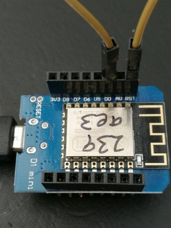

A jumper is connected between the RST pin and the D0 pin on the Wemos d1 mini:
And, finally, the 239ae3.ver file in the OTA store is edited to have a version number of 1.0.4.
