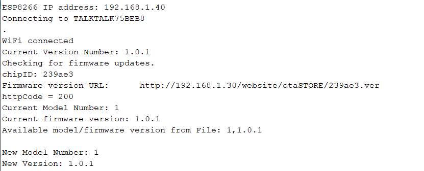

Firstly we construct the full URL of the "version" file, This has the form: http://192.168.1.30/website/otaSTORE/239ae3.ver
The next few lines of code initialise the httpClient, perform a GET command on the version file and eventually return a String variable holding the WHOLE contents of the version file.

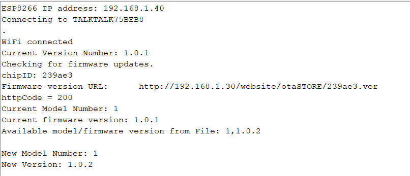

In reality, the version file only contains a single line of text of the form 1,1.0.1  where 1 is the MODEL number and 1.0.1 is the VERSION number. However, as I discovered to my great annoyance, if the line of text is terminated by CR/LF, then the CR and LF characters are included in the string and must be detected and stripped out, otherwise problems will occur.
Here's the section of code which deals with that issue:
    int lengthData = verFileContents.length();
    char testIt = verFileContents.charAt(lengthData - 2);
    if (testIt == 13)
      lengthData = lengthData - 2;
    int comma = verFileContents.indexOf(",");
    String newModel = verFileContents.substring(0, comma);
    String newVersion = verFileContents.substring(comma + 1, lengthData);
    Serial.print( "New Model Number: ");
    Serial.println( newModel );
    Serial.print( "New Version: ");
    Serial.println( newVersion );

Here's the output from the simple sketch to construct the filename and read the contents of the version file:
And, if we change the Version Number to 1.0.2, in the version file, and run the sketch again, we get:
