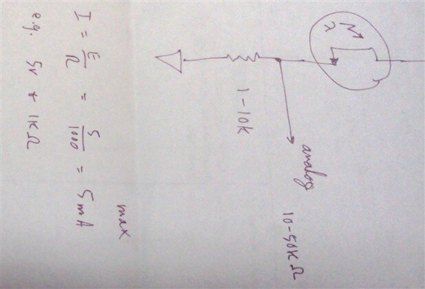

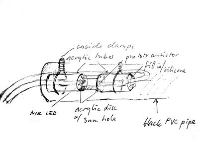

As I believe I've already mentioned, Rolf has also taken over the sensor part of the NIR probe from me (much to my relief), which is modeled on a commercial Optek probe and composed of a near-infrared LED emitting at 850nm and a phototransistor with equivalent reception. Both look exactly like regular LEDs to the untrained eye (i.e. mine), and will eventually be silicone-mounted in a pair of acrylic discs fused onto the end of a pair of acrylic tubes. The major challenge with this set-up is going to be firmly mounting these directly opposed to each other across an open gap, while water-proofing the leads + wires coming off both. All other components will be on the board end for now, so it'll be wires only, but the fact that the leads are at 180° could make it tricky nonetheless. I'll be buying/sourcing acrylic tubes of appropriate diameter and a tube of aquarium silicone (we're assuming it's food as well as fish-safe) tomorrow, so pictures of this soon to come.
The basic NIR sensor circuit
A rough sketch of the NIR probe design
