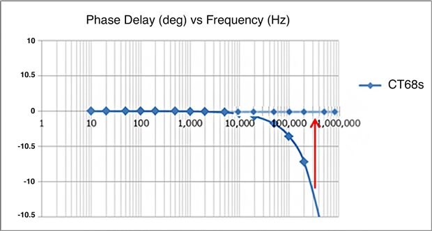

When you enter the phase shift correction value in a power analyzer like HIOKI’s PW6001 then you basically do the same thing because phase shift is essentially a time delay between current and voltage. As an example, here is how this delay looks for a HIOKI CT68 series current sensor. The time delay is shown in nanoseconds against the frequency:
100ns delay at 100Hz doesn’t have the same impact as 100ns delay at 1MHz. This becomes clear when translating the above time delay into phase delay values described in degrees:

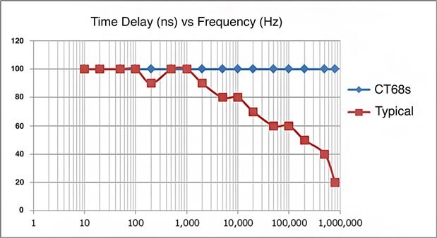

To make things as straight forward as above of course you need a current sensor where the time delay is the same regardless of the frequency. With HIOKI current sensors like the CT68 series this is the case so coming back to the deskew function you only need one value to compensate the phase shift of the sensor.
This is one of the things that makes HIOKI sensors special – but it is not standard for current sensors currently on the market. Here is what would happen with a typical current sensor:
A sensor where the time delay values are different depending on the frequency will make the phase shift compensation in a power analyzer much more difficult. Because which value do you use as your “deskew” parameter?

As you can see there is no phase shift compensation without a power analyzer to support the feature. But as you can also see only the combination of power analyzer and suitable current sensor allows you to perform a proper phase shift compensation in your measurements.
