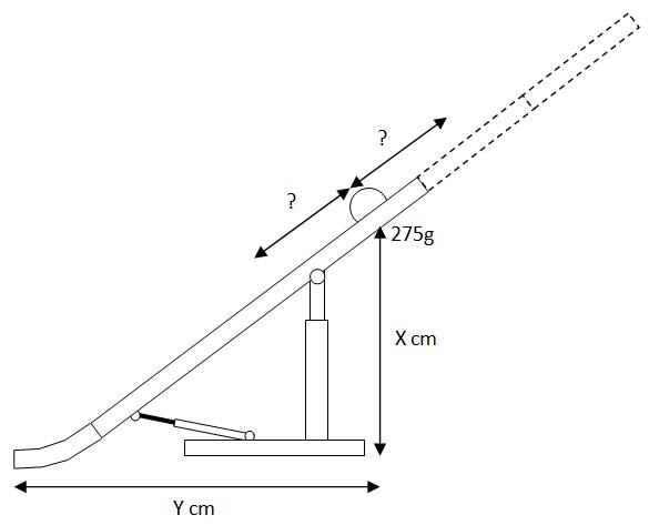

Spending over 11 hours at training to get accustomed to my assistive devices and perfecting my shots got me wondering whether there was a simpler way to determine the exact location of a ball on my ramp that will result in it landing at a particular distance. Let's see whether the following pictures can help illustrate what I mean. Firstly, let us take a look at the ramp and how i use it to propel my balls with the help of my headpointer and sports assistant.
Now on to the physics question. Please refer to the diagram below:
Assume that a ball placed in the location above will travel a distance of 5m upon leaving the tip of the ramp.
1. Relative to the position of the ball above, how far up/down the length of the ramp should the ball be placed to achieve a travelled distance of 3, 7 and 9m?
2. If the height of the ramp is insufficient, how much more ramp extensions (dotted portion in the diagram) is required?
