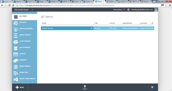

First off, go to the Azure website and click Free Trial. Fill in your details (if you don’t have a Microsoft account/Hotmail/outlook email, you’ll need to open one). After registering click portal at the top of the azure homepage:
And after loading, you should see something like this:
At the bottom left click “new” and then select the options highlighted:
