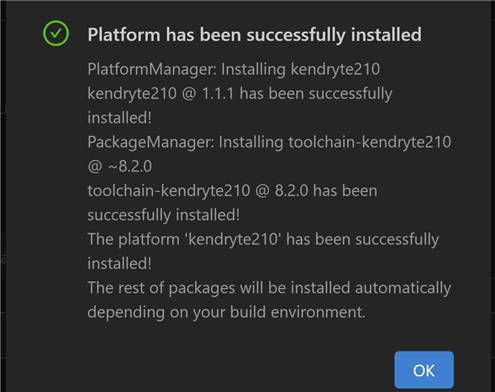

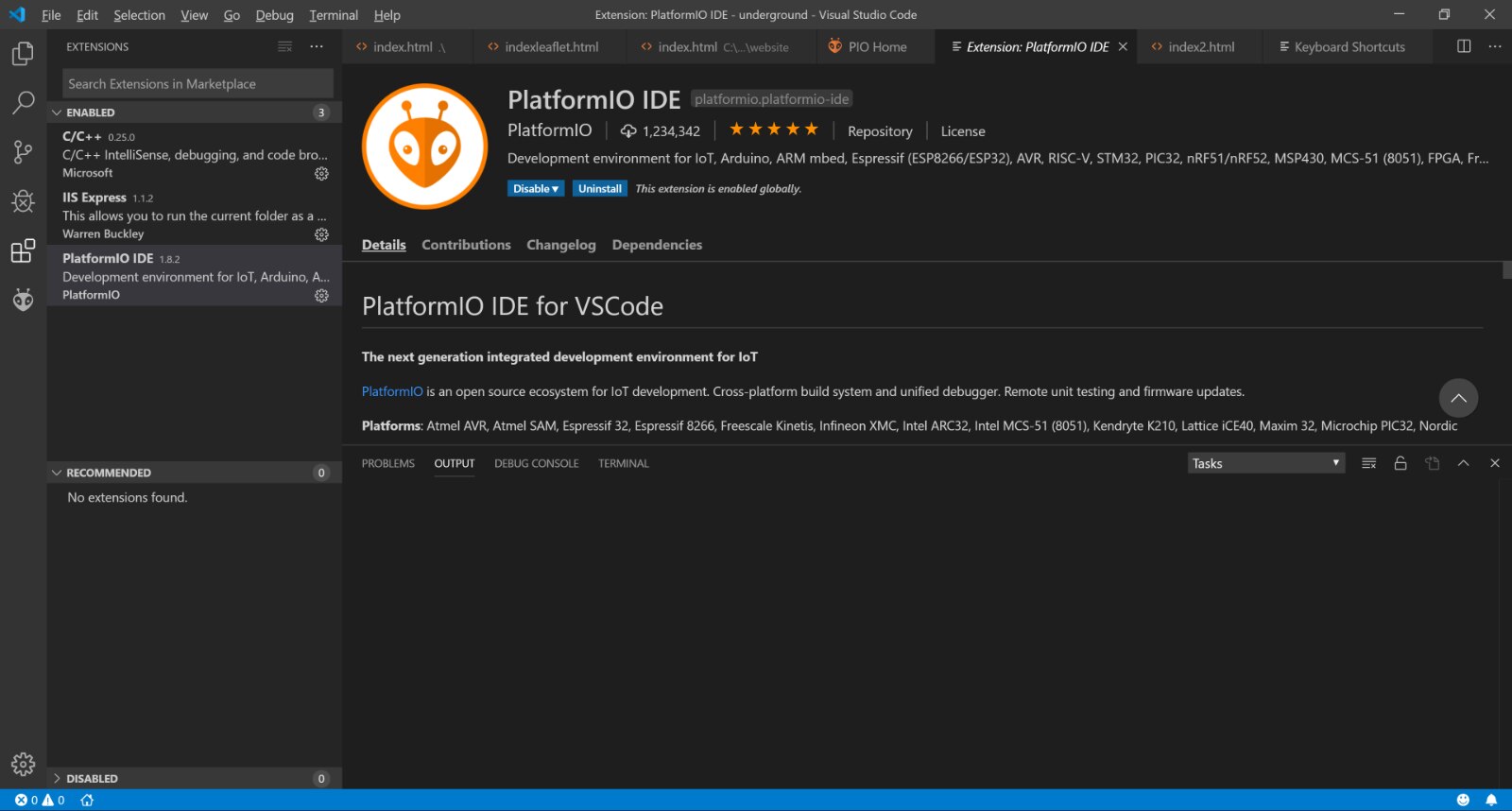

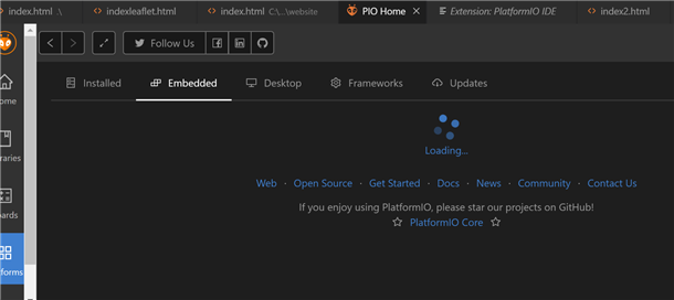

This is step to install PlatformIO IDE. Go to extension and search for PlatformIO IDE, click install and it will install automatically. Upon successful installation, restart VSCode
This is screenshot of PlatformIO IDE

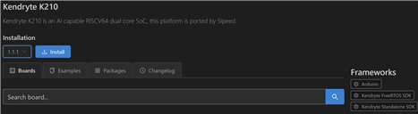

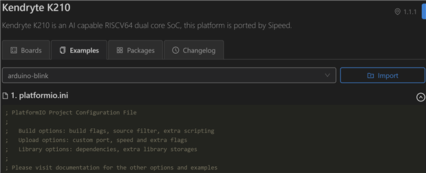

Then we can look for some embedded examples
i choose kendryte 210
after installation, open the Kendryte
