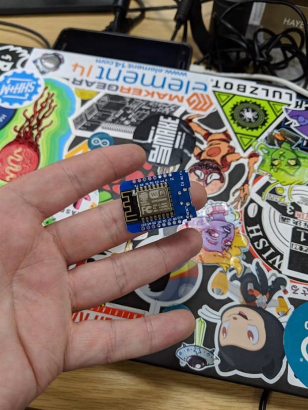

  • e14phil
    e14phil over 7 years ago +2
    I wonder how this would work with a cheap solar panel. I have a Wemos d1 mini ESP8266 sat on my desk right now!

    neilk over 7 years ago in reply to e14phil
    Hi Phil
    I believe (it's on my list for further research) you could connect the output (5V) of a solar panel to the USB input of the Wemos battery shield; have a battery connected and have the shield plugged into the Wemos D1 mini.
    So you would be powering the d1 mini from the battery, and charging the battery from the Solar Panel (when the sun is shining).
    Let me know if you make any progress image
    Neil
  • e14phil
