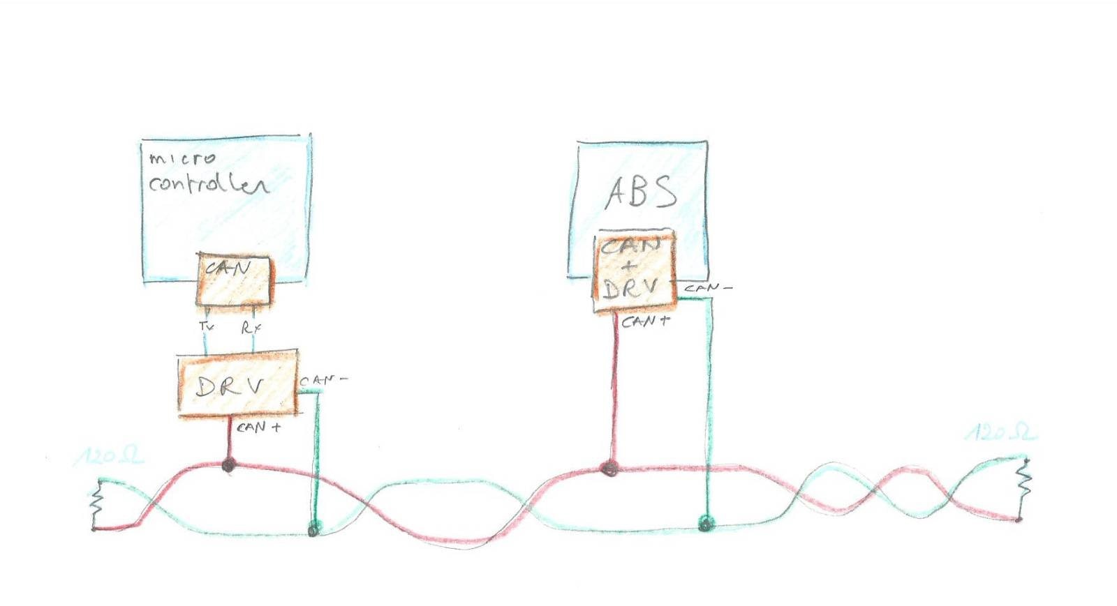

A typical can implementation expects that you use line drivers and twisted pair as the physical wire. And that is the proper way to work.
A common setup is that for Transmit (Tx) , the signal from the controller is translated in the CAN line driver to a balanced signal. For incoming traffic,
the driver picks up the info from the balanced line signal and gives that to the controller's Receive (Rx) pin.
Our Hercules LaunchPads don't have a CAN line driver (some other development boards from TI do have them on-board). But that does not mean that we can't work with CAN.

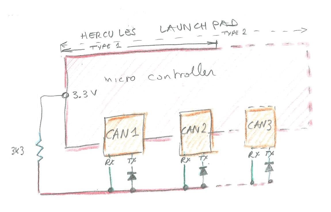

Siemens has published a paper that describes a simplified version: AP2921 On-Board Communication via CAN without Transceiver.
Siemens' setup only requires a single resistor, and a jellybean diode per CAN device. So we can get started with a 3.3K resistor and two diodes.
For our LaunchPads, the schematic for this setup is so easy that we can build it up on a breadboard:
If you have a Hercules LaunchPad MK I (LAUNCHXL-RM42, LAUNCHXL-TMS570004), you'll be able to communicate to 2 CANs.
On the MK II (LAUNCHXL2-RM46, LAUNCHXL2-TMS57012) you can also run that 2 CANs setup, but additionally you 'll be able to extend your setup to 3 CANs.
