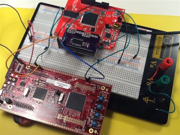

I'm using two affordable instruments here.
My oscilloscope is a second hand Rigol DS1052E.
My logic analyzer is a Papilio Pro. This FPGA development board from Gadget Factory has two duties at Cumps Castle:
I'm using it as my FPGA proto board. It's very good at that
I'm using it as my Open Logic Sniffer compatible logic analyzer. It's very good at that tooimage
As probe, I use a Mueller 250 MHz probe with the 'ground spring' methodology.
That's kind of overkill when you're working with a breadboard - but it does give a cleaner square wave.
