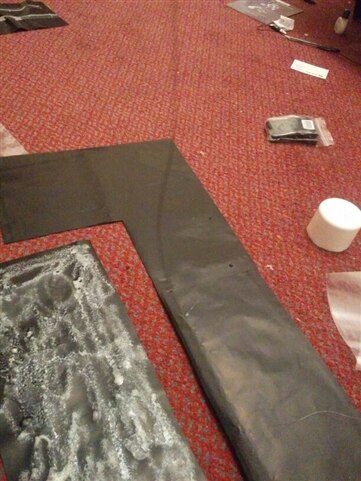

The first part of this guide is to create the actual keys so we can measure when keys are hit. As a brief explanation, velostat is a good material to use as a cheap step sensor because its resistance changes when it's pressurised - aka, stood on. So velostat will be in the centre of each of our keys.

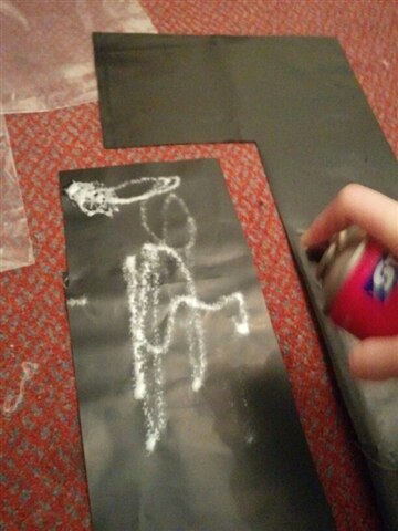

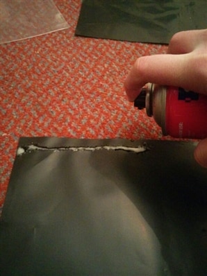

To start this process, we need to glue the sheets together in pairs: we're doing this because the sheets of velostat provided aren't big enough to be floor key sized.

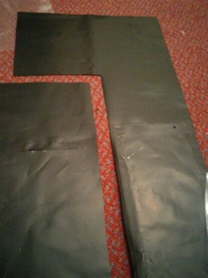

    - first, take 1 sheet of velostat. spray a strip of adhesive along one of the shorter sides, and press a second sheet of velostat (again, shorter side) onto the glue strip. It should only be a few centimetres thick.

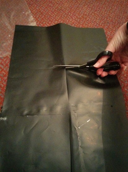

    - when the glue's dried, cut vertically down the velostat all the way through the first sheet, and half way through the second, then cut horizontally. You should now have an L shape, which will be a white key, and a smaller section, which will be a black key.
    - Cut a piece of white material in the same shape and size as the L shaped piece of velostat you cut. Do the same with the black material for the smaller section.

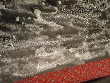

    - Cut a section of conductive thread: make it long enough so that you can stretch from the top of the sensor, to the bottom and round again, with about 10 or so inches left hanging off the top of the sensor.
    - Spray glue all over one side of your first sensor. Press the conductive thread down onto this as described above, and then press either white or black material onto it depending which key you're working on
    - flip the same sensor over and do the same for that side.
