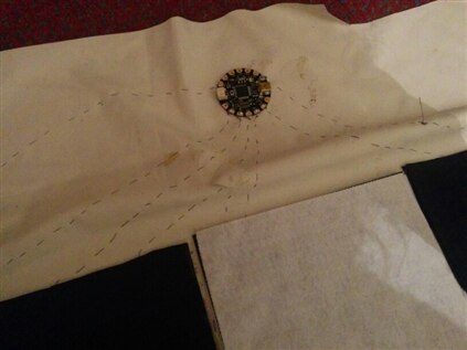

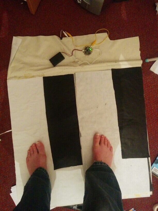

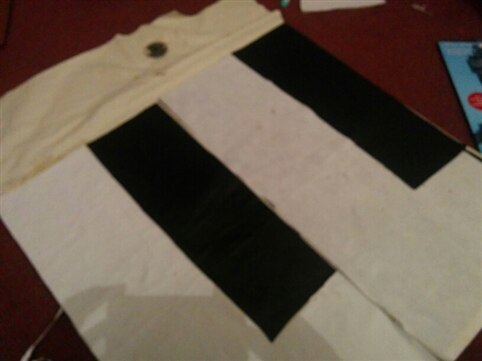

Step 4: Making the keys more permanent
Next up, we're going to lay the keys we made earlier onto a mat and make it permanent so that we don't have to carry around 4 sensors and use alligator clips for everything.
- Begin by cutting the right size material for the mat, including sufficient space to be able to position the FLORA and sew from the keys to the FLORA
- Spray adhesive over each area of the mat you're going to position the keys and stick the key sensors onto the adhesive, taking care to make sure the conductive threads coming from each key do not get stuck to the mat.
- Sew each pair of conductive threads into the mat, connecting one of each thread pairs to one of the Analog pins on the flora (D6-D10) and the other of the thread pairs to GND on the flora. I personally used Sewable snaps so that I could remove the FLORA for other projects, which you can read about on the Adafruit blog.
Your final mat should look something like this:
I haven't shown the buzzer here, or in the code, but that should plug in to a ground and the pin marked "SCL" on your flora - you can either solder this in or alligator clip it if you intend to reuse the FLORA for something else.
Step 5: the final code
Lastly, we need to modify the code written in step 4 so that it applies to each of the 4 keys - this is as simple as setting up a few new variables, as you can see below:
I will note that this still isn't completely bug free, and it will be a bit jittery - part of this is fiddling with margin of error and k values. If anyone lands on the perfect solution to make it not jitter so much, do let me know in the comments section!
