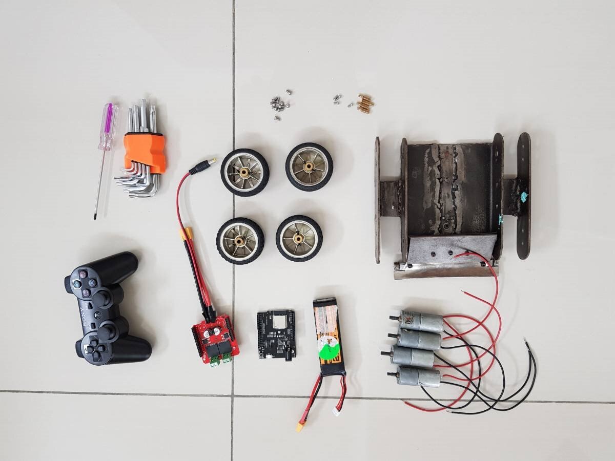

visited my friend's lab few days back. found a lot robot bodies in junk.
it has been sometime since i last build a robot. i think it is a good time for me to pick it up again, since there are ready made robot bodies for me to work on.
found a robot structure in good condition. but almost everything is dismantled from the robot.
Missing screws, nuts, connectors. These are minor problems, I can get it easily from hardware shop.
going to make it as RC robot. RC robot is a good start point.
program is not as complicated as automatic robot. circuitry is relatively simple. one remote control, a 2-channel motor driver. no sensor at all.
list of components:
structure x 1
motor x 4, in fact only 2 are needed. i am using 4 here because it is designed in this way.+_+
wheels x 4.
WiFi UNO based ESP32 board x 1
Monster Motor Shield VNH2SP30 x 1
battery x 1
ps3 remote control x 1
some screws and standoffs.
this is also the reason i starting my last blog post,Interfacing PS3 with ESP32
i wanted to use ps3 as remote control, and the robot has no space for USB host shield.

Yay!, the robot is moving.
