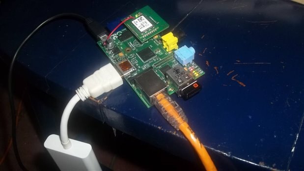

So I am using the Raspberry Pi and EnOcean Pi. I also have a Ethernet cable, a power adapter and SD card that contains the software . The initial set was using this White Paper:
White Papers for Energy Harvesting Wireless Sensor Solutions | EnOcean - Technology

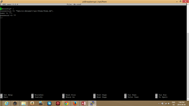

I now see history, current and frontend. While I am still in the /opt/fhem directory I need to set up code to let FHEM  connect to the database:
nano db.conf
%dbconfig= (
connection => "SQLite:dbname=/opt/fhem/fhem.db",
user => "",
It looks like this in putty when complete:

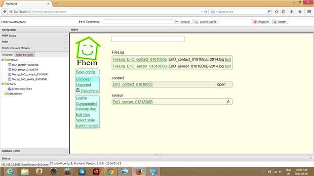

Now in FHEM event monitor enter the following command:
define myDbLog DbLog /opt/fhem/db.conf .*:.*
I waited a few minutes for the software to install.

The first software I tried was the FHEM WebFrontEnd  charts. I invested a considerable amount of time trying to graph some meaningful data. The best I came up with is a Hourly Count of the change in State:

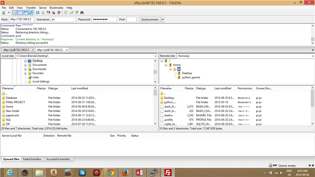

Now I have a .csv file that I can import into Access or Excel. I need to move the file from the Raspberry Pi to my Windows Desktop on my laptop. To do this I used FileZilla.  This is the first time I have used this utility . After connecting the Raspberry Pi in FileZilla I simply highlighted my .csv file and downloaded the file to my desktop.

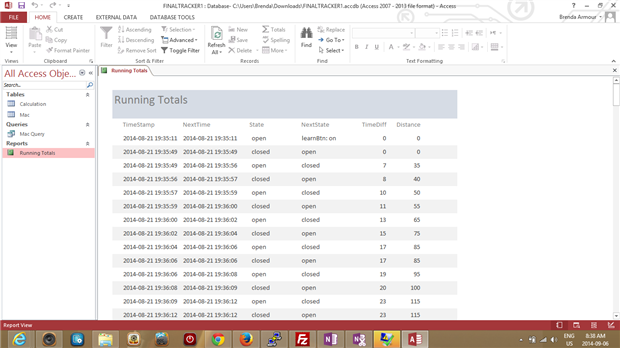

Step 5: Analyzing the data in Access
I imported the .csv file and coverted the file to a table.  A Key field was added to provide a sequential auto number to each record in the table. This will be used in two expression. I created a query to extract the data I wanted to use: State and Time.. That's it ! I need to know when the STATE changes from Closed to Open or Open to Closed to detect movement. This will be explained in more detail in Step .
Fields Created
1: TimeStamp from the imported data
2, State from the imported data
3. Key an auto number
4. NextState: DLookUp("[State]","Mac","[Key]=" & [Key]+1)  This expression finds the next record State and populates the result in the field
5. NextTime: DLookUp("[TimeStamp]","Mac","[Key]=" & [Key]+1) This expression find the next record TimeStamp and populates the result in the field
6. TimeDiff: DateDiff("s",[TimeStamp],[NextTime])  This expression calculates the difference in time in seconds
7. Distance: IIf([State]=[NextState],0,2.36) This expression calculates distance in meters, If the STATE has not changed than there has been no movement. If the STATE has changed than there has been movement
I need running total for the TimeDiff and Distance. I tried DSUM but it would not return the correct results. As a workaround I created report with with the two fields and was able to select the property for each field and select running total.

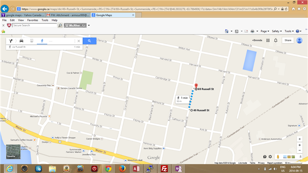

I was given the perfect box for the magnet and sensor. Has I move the box back and forth it changes the status from open to close. This is a crude prototype but does give me an idea what the final product should look like. It will need to be waterproof. I decided to challenge  Google Maps for distance and see how close I come to the measured distance. Time will be measured by a stop watch I will carry in my pocket. I assume Google Map's time is for a normal pace so the Stop Watch will measure my time for the walk. I am a woman of average height 5'6 and I will be taking two steps while moving the sensor. So I calculated 2.640 meters for each change in State (open,closed) . Below are my results:
Google Maps distance: 93.00 m
Sensor Distance:  113.52 m
Margin of Error:  22%
Stop Watch Time: 6.8 mins
Sensor Time: 8.5 mins
Margin of Error: 25%

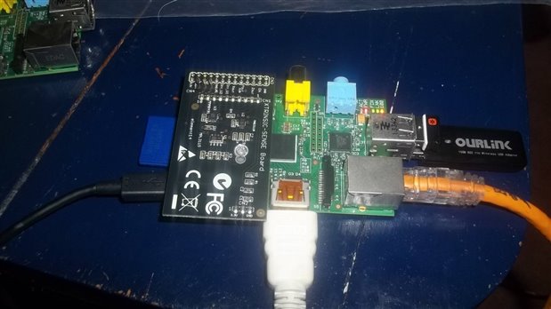

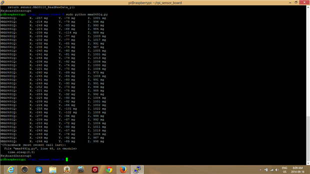

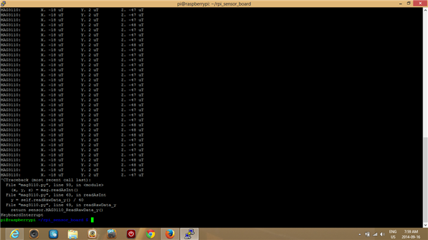

This is the Xtrinsic sense board. It is attached to the Raspberry Pi and contains 3 evaluation sensors. 1. MAG3110 (Magnetometer) 2. MPL3115A2 (temperature/pressure) 3. MMA8491Q (accelerometer). This is an evaluation board. I would like to research the possibility of matching the MAG3110 with the contact sensor. Here is a screen shot of the demo:
This raw data could provide longitude and latitude and so position can be determined. Imagine precision mapping without GPS !
